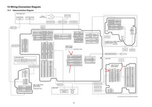

Ive added a picture of the mother board, ive checked the connectors and they seemed fine in fact, the two connector cables which are absent here are new also.
As i dont have a service manual for the FZ1000 II (i dont think they are available ?) i dont know where to start with this or probe to see where power should be coming from to the LCD screen.
