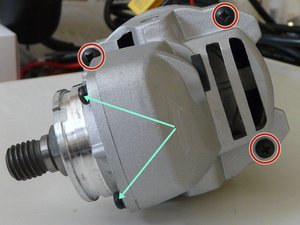

Kenapa gerinda berbunyi kasar dan tidak berputar?
Gerinda saya berbunyi kasar dan tidak berputar
@hermanus2855148 it'll depend on what that noise sounds like. If it is a loud humming, it could be a seized motor. If it makes a loud, different noise then it is absolutely possible that your grinder has issues with the bevel gears. Time to take it apart and have a look at it. You've selected the Bauker PGA115G1.2 as your device. for that use this teardown Disassembling Bauker PGA115G1.2 Angle grinder The only thing you want to do different, is that you only need to open the front part of the case, which contains the gears. Start at Step 10 and remove the 4 screws that hold the bevel gear (marked with blue arrows. there are 2 more on the other side,that are not visible )
then the one that hold the transmission casing to the grinder.
Once you have it apart, check for stripped gears etc. You can always post pictures of what you find etc. with your Question so we can try to help you further, Adding images to an existing question
