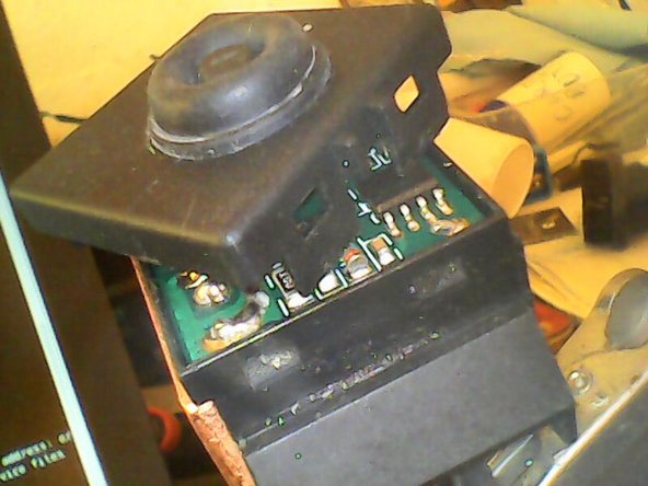

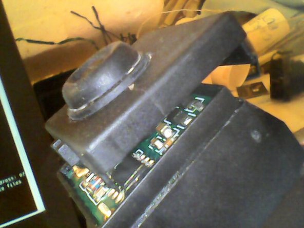

  7. Disassembling Bauker PGA115G1.2 Angle grinder, What is this heatsink?: crwdns2935265:07crwdnd2935265:01crwdnd2935265:03crwdne2935265:0 Disassembling Bauker PGA115G1.2 Angle grinder, What is this heatsink?: crwdns2935265:07crwdnd2935265:02crwdnd2935265:03crwdne2935265:0 Disassembling Bauker PGA115G1.2 Angle grinder, What is this heatsink?: crwdns2935265:07crwdnd2935265:03crwdnd2935265:03crwdne2935265:0
    • The switch with the push button that engages with the black rod is shown here. One of the brush connections can also be seen in the background in this picture.
    • The heatsink is clear. I unscrewed the copper plate and found some white heatsink compound below against what may have been an aluminium plate
    • I had not encountered a heatsink built into a switch before, so I tried to take the switch apart. I could remove the top cover, but the flexible dome resisted all attempts to remove it, but it is possible to see a circuit board inside. The fuzzy pictures through the crack were taken with a boroscope.
    • The switch seemed to be open circuit on the neutral side, so I looked for replacements. This was before I realised that it was an active circuit. The only candidates that I found seemed to be ordinary passive components..
  8. Disassembling Bauker PGA115G1.2 Angle grinder, So what is this switch?: crwdns2935265:08crwdnd2935265:01crwdnd2935265:01crwdne2935265:0
    • The picture shows the markings. It seems to be a JIABEN FA2-5F-1108X, whatever that may be. Can anyone through more light on this, or find a datasheet? Perhaps if I could read chinese it would be easy.
    • What is its function beyond a passive switch?
    • With the help of Google translate, I do now have some information. It offers restart protection when the power supply is interrupted and more. It seems to satisfy EN60947.

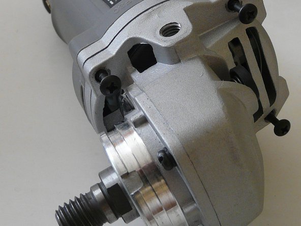

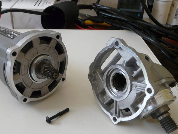

  10. Disassembling Bauker PGA115G1.2 Angle grinder, Remove the front section: crwdns2935265:010crwdnd2935265:01crwdnd2935265:03crwdne2935265:0 Disassembling Bauker PGA115G1.2 Angle grinder, Remove the front section: crwdns2935265:010crwdnd2935265:02crwdnd2935265:03crwdne2935265:0 Disassembling Bauker PGA115G1.2 Angle grinder, Remove the front section: crwdns2935265:010crwdnd2935265:03crwdnd2935265:03crwdne2935265:0
    • There are 4 obvious screws: 3 can be seen in the photograph. I used a PH2 screwdriver to remove them.
    • The front drive section can now be removed as shown.

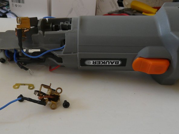

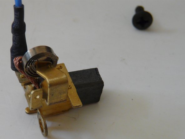

  12. Disassembling Bauker PGA115G1.2 Angle grinder, Remove the brushes: crwdns2935265:012crwdnd2935265:01crwdnd2935265:03crwdne2935265:0 Disassembling Bauker PGA115G1.2 Angle grinder, Remove the brushes: crwdns2935265:012crwdnd2935265:02crwdnd2935265:03crwdne2935265:0 Disassembling Bauker PGA115G1.2 Angle grinder, Remove the brushes: crwdns2935265:012crwdnd2935265:03crwdnd2935265:03crwdne2935265:0
    • The brushes are each held by two PH2 screws: there is a picture in the next step. Unscrew them and carefully remove taking care not to disturb the springs.
    • There is a washer plate with the two screw holes which is best removed to avoid loss. One is shown in the third picture.
    • Obviously it is a good idea to check the brushes and renew if needed.

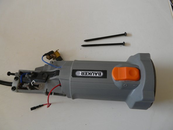

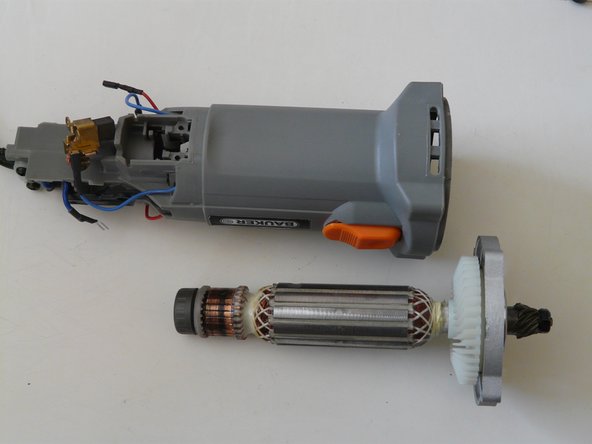

  13. Disassembling Bauker PGA115G1.2 Angle grinder, Remove the rotor: crwdns2935265:013crwdnd2935265:01crwdnd2935265:02crwdne2935265:0 Disassembling Bauker PGA115G1.2 Angle grinder, Remove the rotor: crwdns2935265:013crwdnd2935265:02crwdnd2935265:02crwdne2935265:0
    • The two screws holding one of the brushes are shown.
    • Once the brushes have been removed, the rotor can be withdrawn. Be careful when easing the rear bearing out of its recess. Use a small screw driver to guide the withdrawal.

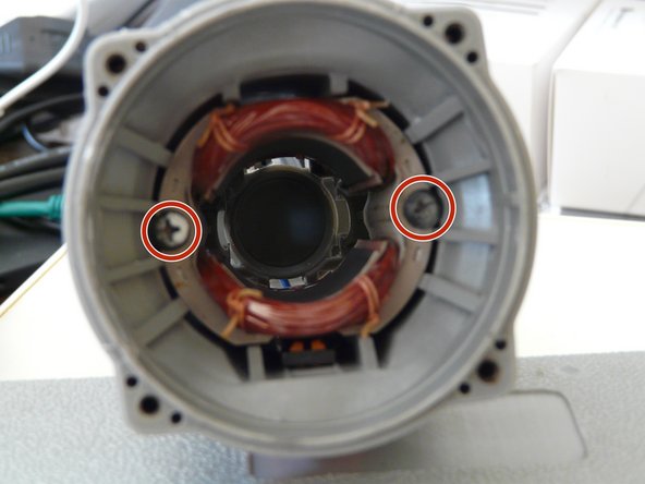

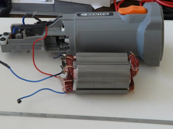

  14. Disassembling Bauker PGA115G1.2 Angle grinder, Remove the stator.: crwdns2935265:014crwdnd2935265:01crwdnd2935265:03crwdne2935265:0 Disassembling Bauker PGA115G1.2 Angle grinder, Remove the stator.: crwdns2935265:014crwdnd2935265:02crwdnd2935265:03crwdne2935265:0 Disassembling Bauker PGA115G1.2 Angle grinder, Remove the stator.: crwdns2935265:014crwdnd2935265:03crwdnd2935265:03crwdne2935265:0
    • You probably only need to remove the stator if it has a fault. In my case one of the leads was broken close to a coil.
    • First remove the front cover: it simply pulls out.
    • The two screws holding the stator can now been seen. As always they seem to be PH2.
    • Unscrew them: they may be quite tight.
  15. Disassembling Bauker PGA115G1.2 Angle grinder, Remove the stator: continued.: crwdns2935265:015crwdnd2935265:01crwdnd2935265:02crwdne2935265:0 Disassembling Bauker PGA115G1.2 Angle grinder, Remove the stator: continued.: crwdns2935265:015crwdnd2935265:02crwdnd2935265:02crwdne2935265:0
    • To remove the stator from the case, it will almost certainly be necessary to use some sort of tool. It might be possible to use some sort of hook, but I decided to try to tap it out from the rear.
    • However it is vital only to apply taps/force to the laminations away from the winding. The case has some small slots where the brushes fit, and those are directly above sections of laminations.
    • I improvised a simple tool by cutting a short section of an almost rectangular rod from an old ventian blind mechanism. That rod has just the right cross section. The picture shows it inserted into one of the holes and resting against the laminations.
    • It only needed a few light taps each side to drive out the stator.
    • The second picture shows the stator removed from the case, and part of the rod in front. The picture has had to be cropped so only a portion is visible.
    • The stator had suffered damage: most obviously the severed lead, but also blackening in the adjacent area and on the other lead. But the coil was intact, and the lead could be repaired
    • To re-install the stator involves threading the right leads through the correct holes. I found this difficult.
    • The way that I did this was by tying pieces of thin string to the leads, and threading those first. But it was then difficult to manipulate the crimp connectors through because the strings had to be tied above them. It took some patience with a variety of probes to achieve this. Perhaps you can find a better way?
