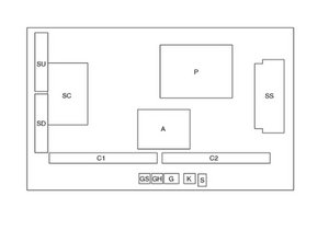

TH-42PZ80LB 8 blink after plumetting around 50 centimeters
My Panasonic TH-42PZ80LB was installled on a MDF pannel which has tumbled down. The TV was working properly and kept working after the impact, but after some time it either remains with the sound but no image or, more often, turns off and the red light blinks 8 times. When I turn it off and on again it works again, but each time it works properly for less time.
@carlosfs 8 blinks leads to the SS board. Here is the trouble we are running into. Since this was a mechanical issue, we'll have to really carefully inspect all the boards but focus on the SS Board. Now the time to take a look at it has arrived :-) Unplug your TV and remove the back cover. Once accomplished, do not touch anything yet, since the capacitors can still be charged and they could pack a punch if you touch them with your bare hands. For now, just take some good pictures of your boards with your Question. that way we can see what you see.
Here is where the SS board is located.
