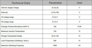

It is impossible to see the markings on the IC with the naked eye. I have taken a photograph of the IC through my microscope and applied filters to get the best image. It appears to have two sets of numbers - PN6013 and L43A2A12. How does one distinguish between the part number and the production number?
I would be gratefulif anyone can shed some light on this - I need to know what type of controller IC it is.

Thank you! It is the right item but no longer available at AliExpress - what a shame!
@madaboutears it's a MOSFET but still not an easy find. You can try TaoBao or Alibaba (not AliExpress). Here is what I got:
PN6013 Integrated standby power consumption quasi-resonant primary-side controller and high avalanche
Capability Intelligent PowerMOSFET, used for high-performance, peripheral components
Streamlined charger, adapter and built-in power supply. PN6013for
Primary side feedback working mode, optocoupler andTL431. Built-in high
The voltage start circuit can realize the no-load loss of the chip (230VAC)Small

I. Overview
PN6013Integrated standby power consumption quasi-resonant primary-side controller and high avalanche capability smart powerMOSFET, for high-performance chargers, adapters and built-in power supplies with reduced peripheral components.PN6013 It is the primary side feedback working mode, and the optocoupler andTL431. Built-in startup circuit can realize chip no-load loss (230VAC) is less than50mW. In constant voltage mode, quasiresonance and multi-mode technology are used to remove audio noise, making the system meet6Class energy efficiency standards, the adjustable output line compensation function allows the system to obtain better load regulation; in constant current mode, the output current and power can beCSThe resistance of the pin is adjusted. The chip provides intelligent protection functions, including cycle-by-cycle over-current protection, over-voltage protection, open-loop protection, over-temperature protection, output short-circuit protection andCSOpen/short circuit protection, etc.

Thanks again, I have all the data now! Will hunt around to see if I can buy some PN6013s. Will let you know.
