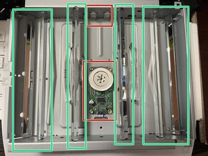

It's usually one of 3 common reasons for these older HP lasers. It's either a bad toner, fuser, or laser issue where it is degraded or dirty.
The first thing I always try when it's borderline is to replace the toner, even if it's reman; a lot of the time, it's some imaging component issue in the toner cart from age, but not always. Either way, these are cheap enough for old models (hint: I pay $25 for 2 80X compatibles for my M401).
If the issue remains with a new toner, do a "halfway test": do a test page and stop it mid-run to see if a bad fuser is introducing the issue. If it's perfect before you get to the fusing unit, the fuser is the culprit; it isn't getting hot enough to melt the toner due to the lamp wearing down. But be mindful of what you pay for the fuser and where you buy it. You want a used low PC fuser (probably pulled from a p2015 with a low PC but failing formatter) as the procedure to change it sucks on these; do it right the first time. See if you can get a rebuilt one from a shop like Precision Roller, Printer Techs or Metrofuser (use your name for the company name). However, it will probably be more than a new printer of similar quality (SMB mono). BUT BEWARE: It's probably not cost-effective.
If the issue is not with the fuser, take the laser apart and see if there is any degradation of the mirror assembly coatings or toner penetration from several years of use; if it builds up enough, it will kill your print quality. You can take the laser out similarly to the fuser but with much less disassembly, but all three panels need to come off.
If the issue is still present with these checks, it is likely with something serious like the power supply. However, replacing the entire printer is probably more cost-effective, much like replacing the laser (and fuser if it's toast).
