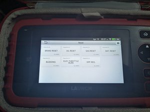

Just plugged scanner in now and there is no codes. However it did let me erase the service light. I'm not certain yet if this scanner will show any braking system codes. I only paid £20 for it from Euro car parts
I will have alook at that link you sent me. Thanks mate
It is unlikely to support ABS; you need a scanner on the higher end of the spectrum. Innova has the 6100p, but others are also available like the 5410.
I checked my lesser capable mid-level scanner to see if it can be done at a budget with a scanner (Launch CRP123X) that supports it, and it does. I also have a 129X (Adds FCA Autoauth support and injector coding, AF reset, throttle relearn, TPMS, AFS. On the diesel side, add the Adblue reset option; this isn't on the 123X by default). I can't add Autoauth support to the 123X as it's only on certified scanners. I'm not sure if you can buy these in the UK; if not, look at similar units.
Be warned: The 129X is often much more expensive (usually ~$100 off sale). The 123X hovers at ~$ $178 or less, and the 129X tends to go for ~$ $258-$280. That said, Autel is MUCH more expensive, even at the lower end, even used. Yes, I tried for a used Autel, Autoauth or not; the issue is the discounts aren't deep enough to risk needing to renew the 1-year update subscription so soon.
