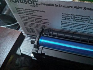

If you see something like this, almost 100% likely to be the toner (I put that in the recycling bin today and as a gag, I removed the cover; it was mostly black waste toner that didn't make it into the Lexmark waste container leaking):

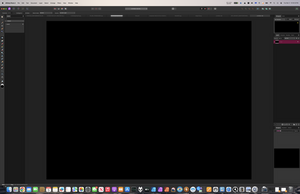

The other test you can do is a "swatch test"; either make CMYK swatches (don't worry about matching the hex code to the letter or number, get it close) and design these in a program like Affinity Photo or PSE; even MS Paint will probably be fine. Make something like this:
Y TestC TestM TestK Test
Yes, this WILL ALMOST CERTAINLY end an already low toner sooner than usual, but it's the quickest way to isolate which toner is causing the banding short of knowing how to get to the SM which sometimes requires a key if the Canon presses are a clue.
