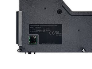

long story short, I live in Argentina, I got myself a Ps5 from Japan (CFI-1200A), voltage input is 100V ~ 3.55A 50/60MHz, electricity here runs at 220v 50Hz.... can I plug it to the wall? Seller says yes, internet says mixed responses, what should I do?

@celalyvan Yes! you can use it in a 200-240V environment. Just like always the Sony PlayStation series uses a power supply that is universal voltage. INPUT VOLTAGE: 100-127V, 4.5A 50/60Hz 200-240V, 2.3A 50/60Hz; Output voltage: +12V, 31A.
You may just need to find a power cord that fits your outlet :-)

@celalyvan that is correct. All labeling is done in accordance with whatever country it was issued too. So this one was issued in a market that uses 100-120V and this has the stickers etc according to that. The same PS 5 issues to the European market will have to have the 220-240V stickers on it. Identical hardware but legal requirement is to label it according to the country it was issued to.You can take it apart and check the actual power supply. You will see that it uses a dual voltage supply.
Of course, that has already been done for you by iFixit. Check the teardown PlayStation 5 Teardown step 10 and you will see this

You need to check to be sure but this is almost always the case on most devices. It's cheaper to to use a SMPS over a linear supply, making linear reserved for edge cases you have no choice.
well but where can i check it, because everywhere i've seen in the box, the console, and the manual, everywhere it says it's 100v!!
@celalyvan that is correct. All labeling is done in accordance with whatever country it was issued too. So this wpone was issued in a market that uses 100-120V and this has the stickers etc according to that. The same PS 5 issues to the European market will have to have the 220-240V stickers on it. Identical hardware but legal requirement is to label it according to the country it was issued to.You can take it apart and check the actual power supply. You will see that it uses a dual voltage supply.

The approach Sony took is uncommon, but it's compatible. Now, there WAS a time you had to know (Ex, PS1/PS2) due to the use of linear power supplies, but the PS4 and PS5 are using the same global power supply across all models due to cost. It's more cost-effective for Sony to use the same part but "localize" it by changing the label; for example, if you were in Japan, it would say 100-120V (Japan has a weird power grid with some areas being 100V, others being 120V). As such, it's commonplace for the Japanese version to mention this, but it's not mentioned in a country like the US, where we use 120V. That said, all of the PS5s use the same 100-240V SMPS.

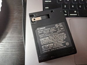

What Canon did on that charger (as an example) is true "global" labeling. This type of label is far more common than what Sony did, but caution is REQUIRED around buying the camera, for example, given that Sony is willing to lock everything out but Japanese on JDM variants of the body ("J1") to discourage importing not meant to be exported.
