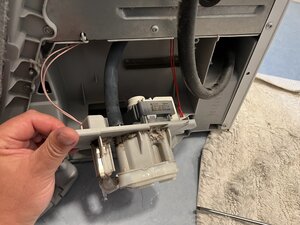

My dryer keeps saying the water reservoir is full, even though it is empty. If I restart the cycle it will work for a couple of minutes and stop again. What is the sensor that is sending this message? And where is it located? TIA

I've had the issue where it is constantly saying the tank is full on the Bosch Serie 6 self cleaning condenser dryer. There is a compartment at the back of the dryer where the pump is. You can pop out the pump and there is a sensor beside it with 2 metal strips that detect the water level. Gunk gets caught between the 2 metal strips, clean that away and it solves that problem.

I just found the compartment and it fixed my Bosch Serie 6. See attached pictures.
There are two snap locks at the top where the screwdriver is pointing on first picture.
