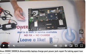

Bluetooth module where located
Where Asus Vivobook S500CA Bluetooth module located on motherboard.

If there is no entry in BIOS or it is enabled there, then as Bluetooth is located on the same module card as the WiFi, perhaps the card is faulty.
Here's an image taken from this teardown video showing where it is located on the motherboard.
(click on image)
Here's a link that has Asus drivers that may also help
