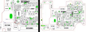

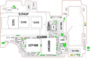

Use a strong light and a magnifying glass to visually inspect the charge port connector to make sure that there are no bent or missing pins and that there's no debris lodged in the port e.g. lint, that may be preventing a good electrical connection with the charge cord plug. If there is any lint etc, use a vacuum cleaner to try and clear it.
If the port appears to be OK then here are some images showing the charging troubleshooting flowchart and also zoomed in and normal sized images showing the components mentioned in the flowchart on the systemboards.

my samsung galaxy m51 is not responding to any kind of charge . I have tested it with realme, xiaomi, motorola and samsung charger and it is showing no sines of charging
@devrajbasera
Follow the troubleshooting flowchart as shown above.
