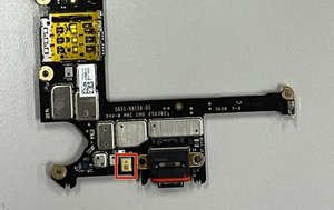

Microphone is broken on phone - no one can hear me.
For the past year or so, I've only been able to to take calls on speakerphone and/or with headphones (with dongle, as there is no jack). I'd like to at least try to repair this mic before recycling it and making a new phone purchase.
I took the phone into a repair shop and they quoted me at $350 for the repair, because it required 'full disassembly, and is likely to break the screen which will require replacement'.
Has anyone here tried to repair the microphone on a pixel 5? What was your experience? Is there a guide you find to be reliable?

The big problem you've got is that the bottom microphone, the one you use during a phone call, is mounted directly on the motherboard. As such, there isn't a part you can just remove and replace like, for instance, the top microphone. Here's the microphone you'd need to replace.
Of course, to even get to it you'll need to take the motherboard out of the phone.
Google Pixel 5 Motherboard Replacement - iFixit Repair Guide
To be honest, I'm not even sure how those microphones come off the circuit board; I'm guessing you may need a hot air station, but I could be wrong. I believe this part is what you'd need to be able to replace that microphone.

At this point it's sounding like this may be more trouble than it's worth to try and fix; entirely up to you, of course, but I'm afraid it's not a simple fix even discounting the hazard of removing that delicate screen.
