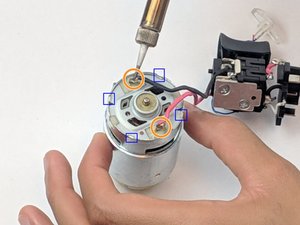

How do you replace the carbon brushes on this unit?

@shawn123478068 so there really is nothing out about this particular tool. It appears as if they are "hiding" the brushes in the end cap. sort of like the Bosch, and Hilti's etc. have on many models. Kind of like this
I would use this guide Ridgid R82005 Motor Replacement and once you are at step 5, check the back. It looks like there are some locking tabs, marked by the blue rectangles
Now try to gently pull /pry the backing off. See what happens. I think the real work starts after that. Trying to find the brushes to match, maybe a PITA since nothing is listed on any of the parts sites. Not even with Ridgid.
