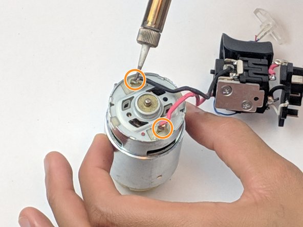

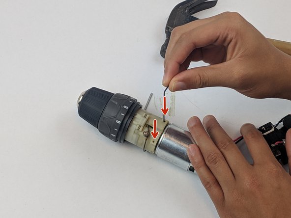

  5. Ridgid R82005  Motor Replacement, Motor: crwdns2935265:05crwdnd2935265:01crwdnd2935265:03crwdne2935265:0 Ridgid R82005  Motor Replacement, Motor: crwdns2935265:05crwdnd2935265:02crwdnd2935265:03crwdne2935265:0 Ridgid R82005  Motor Replacement, Motor: crwdns2935265:05crwdnd2935265:03crwdnd2935265:03crwdne2935265:0
    • Push the two pins through the motor assembly.
    • We used an Alan wrench to push the pins through, but any small tool will do.
    • Unsolder the wires from the back of the motor to free the motor from the trigger assembly.
    • To learn how to solder, check out the How to Solder and Desolder Connections guide.
    • Make sure all drill components fit properly in the grooves of the Housing Assembly.
