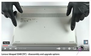

What kind of screwdriver is needed to remove the bottom cover
what kind of screwdriver is needed to remove the bottom cover
Hi @danilgogolenko
Here's an image taken from this teardown video that shows that the screw is a Torx screw.
(click on image)
The specifications for the 10 screws in the base as shown in the hardware maintenance manual (see p.34) are M2.0 x 6.5mm (9 screws) and M2.0 x 3.5mm (1 screw)
M2.0 = 2mm so that is about a T6 or T7 Torx screwdriver.
According to this question, What screwdriver do I need to take off the lower (bottom) case of a and this question which screwdriver do I use? A T5 torx screwdriver is needed. The screw heads in the bottom cover of the Ideapad S340 are reported as being T5 torx screw heads by most users.
A quality small driver kit with several common bit sizes (torx T4,T5,T6, Philips, etc) can be handy; example: Minnow Driver Kit.
