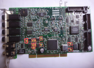

About a EMU APS audio card (it is a PCI card, came out in 1999).
I had made it work with WinXP but after a re-installation of WinXP, and re-install the card (with the same drivers in the same PC), i have this problem :
I have install the drivers, and the card shows in the Device Manager and is enabled in the Mixer but it refused to play audio. It is strange because the peak meter on the Mixer application is moving, which indicates things should be working...
I am trying to make it work now and for 1,5 month with no luck. I have installed all the Windows OS : Win95, Win98, Win2000, WinMe, WinXP, WinVista (with drivers i found on web), but the card do not have sound, in all of these OS''s.
I also gave the card to a technician to examine it if there is a bad circuit, but he told me that the card seems to be OK but he is not 100% sure, and he do not have the time to examine it more closely, because he do these only for expensive cards. When i told him the this card cost, (back in 1999) 700$, he did not believe me.
Something tells me that there is something wrong in the card.
Is there a way to examine it, on board or off board to diagnose if there is something which became bad (a capacitor, a resistor or something else, like the output jacks) ?

After seeing an EMU card repair video, I began to suspect the two capacitors on the card.
Can somebody tell, from the pictures, if one or both of these two capacitors are faulty ?
Or can somebody tell me how to check them ? I have a multi-meter.
@dorosk We will replace both of those capacitors at some point, but first, I'd like to make sure that none of the tantalum caps are faulty.
With your multimeter on diode check mode, check across the two leads of the tantalum capacitor. If the meter continues beeping after a few seconds or shows a low number on the display after a few seconds, the cap might be faulty. Do this for all the capacitors in red boxes in the attached picture and let me know if any of them come up as shorted/faulty.

I test it. The result ere these :
With the red probe in "-" and black probe in "+" lead of the caps, all caps are continuously beebing.
With the red probe in "+" and black probe in "-" lead of the cap, caps no C77, C79, C81 and C82, do not beebing. Caps no C78, C80, C83, C84, C100, C101, continuously beeping.

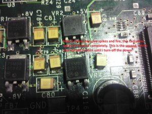

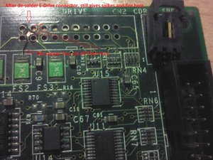

If AndrewS reading, need again help or any idea... After almost 1 year i made everything to bring it back in life. I de-solder about 15 components, found new ones, bought them and also bough a solder station, build a digital microscope and yesterday i replace them all. After i connect it in PC, there were spikes in the E-DRIVE connector. I de-solder it but continue to give spikes and fire in the same area.
I try to clean the area so nothing touch each other and the spikes and fire stop but after a few seconds one of the tantalum capacitors burned completely. I replace it but again burned.
I know that my changes to fix it is almost zero, that is why i am looking if somebody sell one but the only one i found sell both parts ( this card have two parts, the E-Card and the E-Drive). I only need the Card. And it sell it in a very high price.
So if somebody have an idea, i will give it a try...
Finally, after a long period of trying, the problem was solved.
Problem was due to the shorted PLD. Probably by the faulty PSU.
It was repaired by "transplanting" from a donor card. Α forum member gave me this idea and he really helped. It was very difficult to find such a similar card. I found it in an old shop and although it was sold only for spare parts, gave me its PLD and replacing with it the short-circuited PLD of my own original card I made this card work again.
