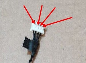

How the 2 cable/4pin adapter looks like:
How the speaker port looks like, another cable/speaker being connected.
Just from plug size its even around twice as big.

@toddk80 there is most likely not a ready-made adapter. You probably have to make one yourself. Ost some pictures of the connector where it was connected to and where it is going to be connected too. Also, a picture of the wiring on the speaker might help. Post those with your Question. You'll have to edit that.

@oldturkey03 Myself just updated the original message with pics. Thanks
@toddk80 were you going to remove whatever is connected to the bottom connector? If so, you can most certainly replace it with the wires from the smaller one. Here is the issue, the black wires look like you have 2 speakers connected, so possible a "stereo" output. We really need to know what motherboard you are using. The model for the boards should be printed on it. Post some good pictures of your motherboard with your Question.

@toddk80 I think the last bit we need to know is, if you can determine where the two cables from the speaker connect to. It looks like there is a jumper on the connector....
I had to post this as an answer so i could attach the image. Once we know where the wires go, I will delete it :-)

@toddk80 the small white connector looks like a JST4PL connector and the one on your board looks like either a MPC2 or MPC4. You can remove the wires by using a needle, small nail, brad etc. to push through each corresponding hole on the connector. That will force the latching hook down and while you press down, you can then pull the wire out of the connector. With a new connect you could now cut the wire from the one you no longer need and use the new copper connectors (the ones that come with the connector) and crip those wires on. You could also get a cable that has the MPC2 connector on it and whatever else on the other side. Then cut the other side off and solder your speaker wires to those ends.
I have not found a male JST4PL connector to make an adapter so you don't have to remove the ends from your cables.
It all (4) goes into the Dell front speaker for sure. Would need to disassemble it for taking detailed look, so i guess no option. :-(
@toddk80 if all 4 connect then there might just a be SPKR Detect line on that. That makes things a bit more difficult. Use some test cables, something with some alligator cables and connect your "New" speaker" with those to the connector o see if you will get sound.
