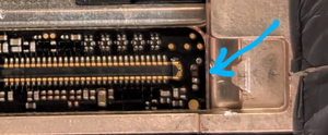

OK guys. I fixed it. 100% it is a hardware issue. Basically Tomasz Góra @tomaszgora is correct. There are two tiny SMD components right underneath where people pry at the retaining bar for the screen connector. One is a 51 ohm resistor. The other is a 33pf capacitor. Both are size 0201 (very, very small). Restoring them will bring the mic 1 back. Attached pics below. The 51 ohm resistor is above the tip of the blue arrow and the 33pf capacitor is just below it. If the component comes off, it can take the pads with it. You can see missing pads in the first pic below. My soldering job isn't pretty but it works. I managed to pick up from what was left of the pads. The 2 pads in the middle between the resistor and capacitor are joined. That is where the signal comes from / goes to the other end of the 51ohm resistor. The other end of the capacitor is a ground. Hopefully this will help somebody. 100% fixed on mine. Stands to reason the parts get damaged when people pry up the retention bar to remove the screen. A nice chap called Stefan on GadgetUK Discord identified the component values.
Good luck
You are missing 2 SMD components. Probably torn off whilst prying up the screen connector clamp. Se pics below. Above top of blue arrow is 51 ohm resistor. Below tip of blue arrow is 33pf capacitor. Both very small. 0201 size. If you lose one of the two middle pads then don't worry, They are joined. Pics attached of problem and fix. Soldering now the best but area is tiny and it works. 100% hardware issue. Please add a warning to the screen change guide. Good luck All. [image|3674422] [image|3674423]
I think this is the true issue.
Thank you for pointing that out.

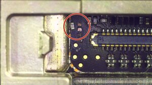

Hi everyone,
I recently replaced the screen on my Pixel 7 Pro, and after reassembly, the bottom microphone stopped working. While inspecting the motherboard under a microscope, I noticed that a small component near the screen connector might have been damaged during reinstallation.
It’s possible that this component is part of the microphone circuit, which could explain the issue. Has anyone experienced something similar? Could someone help identify the component and confirm whether it’s related to the microphone function?

@tomaszgora Did you ever get this fixed? I have the EXACT same problem on my Pixel 7 Pro...missing one of those components! Does anyone know what the types and values of those 2 components are in the photo?
I really don't have the time to pursue this to the next level. But I might just make the time. This is ridiculous that Google is not helping with this problem.
I faced the same issue after display replacement and it seems like the 51 ohm resistor near the display clamp is missing, probably because I was harsh when pried out the clamp. I left it for diagnosis and possibly repair to a technician, will update after result.

I am facing the same issue and I can confirm what PlanC said. I opened the phone again and the resistor is gone. This was a very bad engineering choice from Google, as removing that bracket requires force to be applied in a way that is VERY likely to tear off these components. I do not think I will bother repairing this, as I have already spent enough fixing this now 3 years old phone. Maybe I'll find a cheap, half broken Pixel 7 Pro and swap the motherboards.
