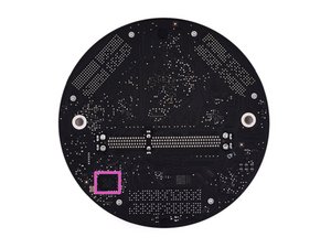

Where is the SMC Chip?
Hi everybody, I am wondering where is the smc chip on the mac pro, because of PFM006 (no ppn001), can someone help me?

The SMC is located on the backside of this daughterboard all the way at the base of the machine.
