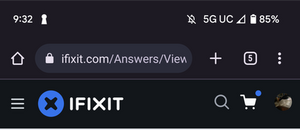

@jayeff I found something a little odd revisiting this being I have two phones. My iPhone 12 (physical SIM, R15) is completely blocked from 2G but my P7 has 2G in the options to force it. I can also enable 3G on my 7, but it kicks back to EDGE/2G.
Maybe the OP might at least be able to get the R15 SIM and bide a little more time, but if this was my phone I'd just retire it and get a new one. Or if it was someone I knew who relied on it and couldn't afford one and was adamant about having a basic phone I'd just buy them a $150 unlocked 4G flip phone and tell them it will need a new SIM card for $15. I can probably enable it because I own a fully unlocked 7 that left Google's hands that way, and T-Mobile can't control that toggle :-). The iPhone is unlocked too, so I think it's how the SIM handles it.
If you're in the US, the odds are bleek; these phones are holding on by a thread. The big 3 are either done with it (2017 for AT&T, December 2022 for Verizon) or phasing it out, with a new activation block -- T-Mobile is the ONLY holdout who blocked new setups in 2021 with the R15 physical SIM release (so it may not like your Pantech, sadly; unless they still have the transition SIM for phones like this) with all but a small M2M coverage range being taken out AND that ends in 2024 (4/2) as well. These phones are only serviced due to the M2M bands covering old cell phones as well as things like parking meters.
It likely no longer works now because outside of that M2M coverage (which is minuscule, and pretty much only there to keep the security alarm industry happy and avoid an attempted forced FCC extension, like AT&T with 3G). More than likely it's effectively shut down in practice in your area, or locked down to M2M devices and restricted from phones. You will need to ask your carrier to check on that to confirm, but at least on mine I can force enable 2G, but my iPhone with the R15 SIM blocks it out (likely because I have a 12).
eSIM P7:
iPhone (R15 physical):
