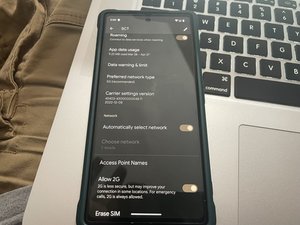

Because the phone is so new and was worth unlocking I verified the financial status with T-Mobile before I put it in the parts bin. I was told the IMEI was clear so I got it setup on my 2nd phone number and did the 14-day/$100 balance unlock process. The physical SIM is confirmed to be unlocked, but I am still seeing the same restrictions as when it was locked with the eSIM:

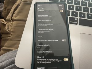

T-Mo 6a (T-Mobile ROM, Sprint supported):

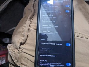

Factory unlocked P7 (Google ROM, TNX required for Sprint accounts):
My P7 is a "virgin" in the sense it was never carrier locked as it was sold factory unlocked, but this 6a still appears to have the eSIM locked down while my 7 shows all of the current US carriers except Sprint being TNX only.
I put a dead AT&T test SIM in it and it took it so I can indeed confirm the physical SIM is unlocked and I no longer get the carrier not supported error on the physical SIM, but the eSIM only shows T-Mobile/Sprint, even after getting it unlocked but without the carrier not supported error. Normally unlocked Pixels show AT&T/T-Mobile/Verizon/Sprint/Fi (TNX optional) or AT&T/T-Mobile/Verizon/Fi (TNX REQUIRED), not just the original carrier. I can also toggle the bootloader unlock option which is normal when the SIM lock is gone or never existed*.

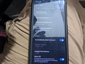

This ex T-Mo 6a is weird on the eSIM. I put a Keepgo data-only eSIM on it ($8 test) and it defaulted to T-Mobile despite Keepgo using AT&T and T-Mobile -- the point of using an MNVO and not a straight carrier is the test was cheap and would in theory go to their best network rather then one on the ROM APN/PRL preferred list, and it still goes to T-Mobile first; you have to swap it manually with a MNVO like Keepgo unless the provider does it under the tower level vs the phone and they only show one provider. What kind of disturbs me a bit is I never told the phone it was formerly carrier locked and was originally a locked T-Mobile phone (and making sure that it's free by erasing both the phone and eSIM at once as I needed to pay the troll toll). It somehow seen it was formerly a locked T-Mobile device and picked their APN with no regard for other providers first. I no longer considered it a T-Mobile device once the unlock was done and finalized. The ONLY VISIBLE DIFFERENCE WITH T-MOBILE is it won't flag their system as my unlocked P7 does 🙃. At this point they know I own my phones, will never buy a locked phone and don't give me a lick of trouble about it (either my P7 or iPhone). The fact I can even unlock the bootloader which is a unicorn in itself because knowing how rotten Verizon is about it (with AT&T being a runner-up for their list of excuses) so I've essentially made it 95% of a factory unlocked phone now, outside of the ROM and internal flags T-Mobile has.
I can confirm it is eSIM unlocked since I was able to override this but despite unlocking it the phone took the T-Mobile APN settings first thing before anything else could pick. I never told Keepgo I unlocked this phone, or even called them. The phone spoke for it. This makes me think they unlock the eSIM in the way Sprint unlocked phones for years but without the lies about it being impossible when that was a load of BS -- they fully unlock it (in comparison, Sprint only SIM unlocked for international use, but hard locked domestic use), for these eSIM T-Mobile phones the eSIM is biased towards THEM or their network. The physical SIM doesn't give it that kind of control, so if I put in an AT&T SIM it does what the SIM commands.

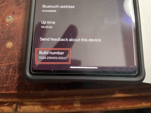

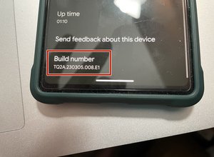

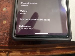

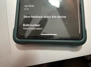

THERE IS A DIFFERENT ROM ON THIS PHONE COMPARED TO THE UNLOCKED SKU, as can be seen here on a known unlocked 6a, the (ex-locked) 6a has a ROM variation for T-Mobile that nudges the phone towards T-Mobile. This is why I think my 7 didn't do this; I have a factory unlocked 7, so mine has always had the carrier-agnostic ROM. Short of unlocking the bootloader to dump this T-Mobile ROM and flashing the Google ROM on it (the part numbers on the carrier SKUs also vary between phones whereas the "unlocked" phones use an unlocked part number exclusive to the unlocked phone, likely due to carrier ROM signature variants and so Verizon can hard lock their bootloader out of sheer spite) and having to restore to back to stock for it to boot with a "locked" bootloader, the only solution to this problem is to use a physical SIM to make the phone obey your wishes or force it to use other networks with eSIM with MNVO providers who source out service from the big 3. RIDICULOUS.
