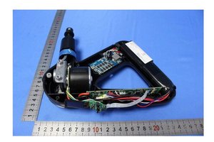

Theragun Elite (white) pictures to support recent teardown efforts.
Still not found a battery source.

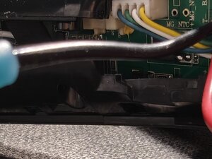

Its a %#*@ hard unit to open up, you need to pry the covers off the sides of the unit as well as the one on the handle. Take the screws out and then pry open the lower handle enough to get the battery unit out. This saves taking off the blue end of the unit where the part is that hammers.
I just attached a 6volt battery into the circuit (positive to positive etc) and it was enough to get a bit of a charge and shock the batteries into charging again when you plug it back in. I'm sure a 12 volt battery would have been better but thats all I has and it seemed to work.

I opened my Theragun Elite and tested the 18650 batteries with a multimeter - read as 0.3 V each, so this confirmed that there was a problem with the battery to the point where it wasn’t able to be recharged anymore. It seems the internals are not truly in sync with the battery, so it would read as charged to 100% even though the battery was not accepting charge at this low voltage.
I am a beginner at spot welding and handling 18650 batteries, but it was fairly easy to disconnect the 3 native batteries from the circuit and spot weld 3 new batteries (I purchased 2500 mAh 20A from bulkbattery) that were in series. I wasn’t able to record, but there are tons of guides on YouTube on how to spot weld 18650s, so I would reference any of those.
Once connected, the unit works again and also has an accurate charging indicator. Hope this helps someone - I am an absolute beginner with DIY projects but this was very manageable and fun to learn about the capabilities of 18650 li-ion batteries. Happy to answer any questions!

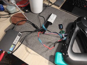

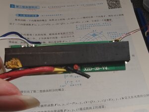

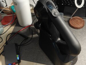

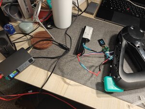

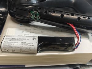

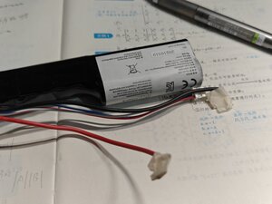

I recently got a second-hand Theragun Elite G3 (the one with DC 4017 powerwell input) for 350 RMB (about 50USD) from Xianyu (the largest second-hand/personal website from Alibaba), and the battery seems dead. And I tore it down according to the helpful guidelines above.
The battery uses three Samsung 25R 18650 lithium-ion batteries, which were connected in a serial way; in my case, they were tested using a multimeter; two of them had an open-circuit voltage of about 0 volts, which indicates their SOC(state of charge) is in a negative state. This is normally what is called extreme overdischarge. One of them is overdischarged, its open-circuit voltage is at about 2.5V. They were connected to the machine by a protective board, and the power cable was soldered to the control board. Three extra cables using a JST connector transmit the NTC signal (thermal information of each battery) from three electric thermocouples. The device won't boot or show anything if these 3 NTC signals are absent.
So I tried to use a digital-controlled-adjustable power source to charge the two dead ones, and closely monitor them using a thermo camera, unfortunately, that didn't do much help. *(This is a bit dangerous, and if you don't know what you are doing and do not have any experience with Lithium-ion batteries, please DO NOT try this at home).
The model for the battery is TG-G3-25S, and I was able to find them brand new at a cheap price on Xianyu for 59RMB (approximately 8.28 USD at this time). The seller was from Zhuhai, Guangdong, which is where the battery and the Theragun manufacturing factory are located. I assume there were spare parts from the factory. The battery's manufacturing date was 2020, and the seller promised me they were never used and were in a proper state.
I also noticed there were other models from other buyers in models such as Elite-QR001B-RBA (2023-11-28), TB-F1-01 ......, there were also swappable batteries for G3/G4 pro, and the latest model, which has a type-C port, not a DC 17 diameter port like the legacy one. But I don't need them, so I gave up buying them. I also bought some motors from Theragun because they look nice, and they might come in handy. The 12V motor can be purchased at Taobao at about 10 RMB - 20RMB, depending on the model. I got a BL3435, BL4539P-L, and a BL2827S for 40 RMB total.
The battery hasn't arrived, so I would wait and see how they are when they arrive.
The information above is to help someone who can't find an alternative, and their battery cell might be dead like mine. Personally, I won't recommend anyone buy a Theragun. They intentionally make it hard to open and repair things; it would come off easily if not the massage tips were designed like this
. I guess someone could use an electric grinder pen to remove the pressed metal, which prevents the nylon plastic cover from coming off, and then the plastic and stuff would come off.

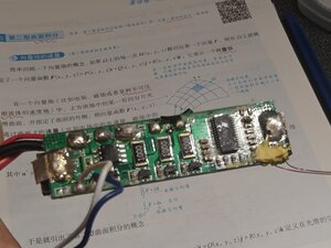

Update (09/13/25)

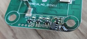

The protective board uses the BM3451SMDC-T28A, which is a rare component. I can't wrap my head around how cells like Samsung 25R, which have a good reputation, would overdischarge like this. There must be something wrong with their battery management solution to have such a wide range of battery failures. According to the datasheet, BM3451SMDC-T28A has charge balance and overcharge protection. I never use components from BYD IC, and I think they really shouldn't cut corners on these things, or maybe they did this on purpose? Texas Instruments has far superior solutions for battery management. As a so-called California Brand, they really used as much cheap Chinese IC as possible to reduce costs. And I suspect that everything of their electrical design is outsourced to a not-so-great engineering team with little durability and longevity testing.
Update (09/16/25)
Charge the new battery to approximately 10V, as it has been in the warehouse for 4 years, according to its marking. and connect it to the logic board, and voila, everything runs fine. Just cut the old battery off and connect them properly like I do, keep an eye on the length of the wire, I made a mistake and have to cut them short, that's unnecessary and exhausting.

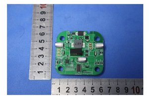

The two battery packs for my Theragun Pro Gen 4 wouldn't charge so I opened the charging dock to take some measurements and found a burned resistor.
From the dimensions and code on the chip, it was a 100 ohm , 1/4 watt surtace mount device.
I replaced it with a 1/4 watt axial resistor and the dock was able to charge both my packs.
(I had to solder tack wires to other points of the board since the surface mount pads were damaged by the overheating.
I used a meter to trace where else I could attach the new resistor.
One end of the resistor went to a cap pad.
and the other end went to a diode pad)
From the photos in an earlier post on a 3-cell battery and dock, I can see that a smaller 1/8 watt surface mount resistor was originally used on the board. I suspect they needed to increase the wattage to handle a 4-cell battery pack and since the larger device would not fit on the existing circuit board pads, they tack soldered the larger resistor in place at an angle, and also milled away part of the case so it would fit. There was a cold solder joint that probably had high resistance and the resistor overheated and failed.

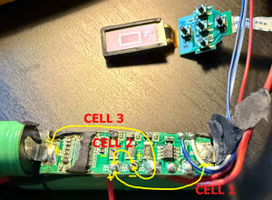

Theragun Elite, no replaceable battery.
Took apart by prying off the covers. The right side is the side to pry off. Then pry off the rubber where the display is. I broke mine rubber part.
Next undo all the screws. There should be 13 in total, two silver and the rest black.
At this point you can pry it open enough to remove the battery pack.
Remove the wrap from the battery pack where the PCB is. This is the thinner part. Remove the rubbery material as well over the PCB.
Next using a digital multimeter (DMM) measure each battery (positive first, negative second)
  1. B1 to B- (tab the battery connects to the PCB)
  2. B2 to B1
  3. B+ (tab the double stacked battery connect to the PCB) to B2
All should be above 2.5V. Mine where the following.
  1. 1.4V
  2. 2.5V
  3. 2.5V
I believe the PCB uses the bottom most cell (1) for the electronics when turned off, so it will drain lower than 2.5V. The safety circuit, if I recall correctly from previous medical devices I designed will not charge if the battery terminal voltages are below 2.5V.
To resolve my issue I set my bench top power supply to 3.6V and limited the current to 300mA. I touched the leads to B1 (positive) and B- (negative). In my opinion you DO NOT want to give it anything higher than 4.2V, so another single lithium ion battery would work, or even two AA in series. The goal is to get the voltage above 2.5V. I see a picture of a 9V battery (really just 6 x AAAA) and another poster said a ryobi 18V! Definitely not recommended as over voltage stress is real....
As I did this I watched the bench top power supply voltage tick up as energy was put into the battery. At 3V I stopped and measured the voltage with the DMM again. I then plugged it and the display said 10%, previously when I plugged it in it would say 0%.
At 23% I unplugged the AC/DC adapter and turned it on. It worked! right now the voltages are:
  1. 3.568
  2. 3.556
  3. 3.559
They are all close to one another which is good. Unplugging the charger I get the following:
  1. 3.508
  2. 3.497
  3. 3.486
These are balanced enough, so the cells seem to be good. If one was lower than the rest (difference more than 0.100V), I would scrap the Theragun Elite and not bother wasting more time on it. I enjoy fixing things, but I have to draw the line at 2 hours maximum.
