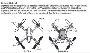

Why my drone does not fly high
it can only fly lower than 4cm
Hi @s1p15darryllee
Check that the propellers and motors have been installed correctly.
Here's an image that shows how they should be fitted.
(click on image)
thanks,that help
