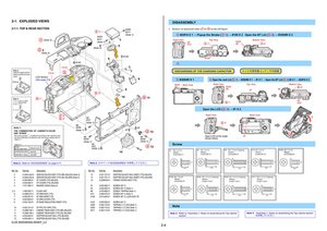

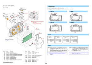

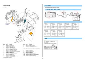

Anybody has a description how to remove EVF in a6000?
Anybody has a description how to remove EVF in a6000? Not the LCD screen, but the actual viewfinder. What screws are holding it and is there an electronic strap? Series of photos or a video would help. TIA.
Alex Ryazanov this Sony α6000 Motherboard Replacement is definitely a good guide to get you into the camera. Step 17 shows you the location of the screw to hold the VF in. Combine that with the Sony SM Disassembly ==>Sony A6000 Disassembly<== for the camera and you should get to it with relative ease. Sometimes it takes more than one source to get it done. Check the screw 309 and mind the hook.
