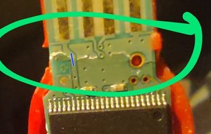

I have this SanDisk flash drive that has been cracked. I am wondering if there is any way to retrieve my data. I have found a couple videos that show recovery experts attempting to solder it where the wires may be broken or switch the nand and the connector chip. Has anyone ever had this performed on their SanDisk and if so, how likely is it to actually work?

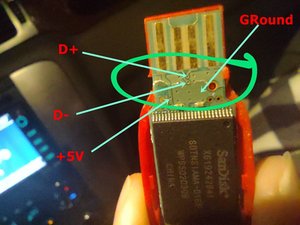

@tgrant2009 get yourself a USB cable, chop the end off. Then solder the wire directly to the broken drive. Plug your cable in, hopefully have the drive being recognized and pull all of your files off ASAP. Then discard the drive. To solder the wires, use the holes at the end of the traces. Use something like a scalpel to gently scrape the masking away until you get to the copper. GENTLY! Ground and the+5V is where you are having to go past the "crack" to solder it. The data line traces look like they are still intact.

I dunno, guys, it looks doable to me. You only need the four connections between the main part of the board and that connector. What I see is that most of the area where it's broken is ground plane. It looks to me like the main power (+5VDC) trace is broken and could be patched over fairly easily.
What you'd need to do is scrape off the solder mask (the green coating) from the circuit trace on either side of the break, then lay a short piece of wire over the trace, bridging the gap. Solder the wire down on both sides and your power line should be restored. I marked in blue the approximate length and placement of the wire; the solder mask should be scraped off down to the metal trace all along the length of that wire.
T Grant, can you post a similar picture of the other side? The two data pins that are going to be needed go through a via to the opposite side of the board, so I can't tell if they're still intact or not.
@dadibrokeit - A few of these are very fine traces barely thinker than a thick hair! And as the fiberglass is weakened it will flex ripping the patch.
@danj Well, maybe, but that's why I wanted to see the other side. The ground trace on this side is still connected to the pin and the repair for the power trace doesn't look all that difficult.
This repair only has to last long enough to plug it in once and recover the data, so I'm not all that concerned with the broken fiberglass at this point.
Hello, perhaps you already solved the problem, from what i see that is not so hard if you have soldering skills, it can be somewhat easy to recover this. The problem in my opinion is mostly on the second picture those two broken traces, go to a electronic repair tech that have good skills it will be solved. (EDIT seems the +5v is missing too on the first picture the pin to the left that needs to be restored before all
