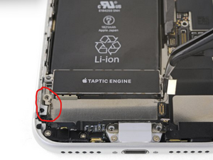

What is this mystery piece?
I was in the process of reinstalling my haptic engine after I swapped the battery in my iphone SE2020. there is this tiny metal bracket that is now loose that I didn't see in the directions. does anyone know what it is and where it goes?

I am not 100% sure but it might be this part of the dock.
It sits on top of the left side of the TicTacTapTic engine.
That’s where I ended up putting it and it seemed to fit correctly. Thanks.
