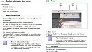

Does the door switch control power to bosch dishwasher model shxm98w75n
Hi,
Not quite sure bit I think that your model is nearly the same as the Bosch 800 series dishwasher.
Here's an image taken from the service manual for the series that shows how to test the door sensor (switch?)
The door switch doesn't control the power to the dishwasher, it is used to signal the control board that the door is either open or shut so that the dishwashing/drying action etc can either commence/recommence or be stopped by the control board.
(click on image)
Apologies if it is not the same as yours.
