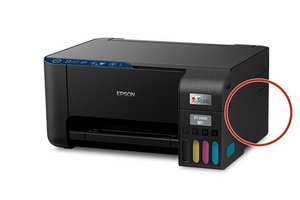

I am thinking about buying an ET-2400 (brief Black Friday discount = $179) and I have done my research but the one thing that seems to have almost no information is the waste ink pad situation. From Epson's ET-2400 user guide (see pages 159-160) it tells me that there are 2 different inkpads (one for borderless printing, the other for normal printing). But it also says that these pads are NOT user serviceable components (so there is no Maintenance Box to buy) and that it requires they be replaced by an "authorized Epson service provider".
  1. Any idea roughly how often these pads need replacing?
  2. Any idea what it costs to have it done the official Epson way?
  3. Any tutorials on DIY that is written specifically for the ET-2400 (for either or both types of ink pads) ??
Any help with any of these questions is appreciated.

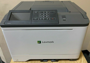

Despite good color and B/W models starting at $400+, I use laser printers for a reason. That being said, if I get a deal on a used high-end model like a split drum/developer Lexmark CS with a low page count, I usually take it over dealing with inkjet for a reason: This isn't a problem. However, they're more expensive to maintain than an ink tank printer like these Epsons and are more needy in terms of consumables (Ex: drums, toner and developer on the CSX10 models, whereas Lexmark sells them as a paired set with the CSX20 and up; same for the CX AIOs). Even the transfer belt and fuser are "150-200k page" maintenance items on some models.
The other reason I generally do not recommend them to anyone is their bulk: These things are heavy, as in 50+ lbs, and some units require light parking lot breakdown of the tray assemblies to fit in an average car unless you have a box truck.
The best ones in this "lots of consumables, cheap to run" category for laser printers are machines like the Lexmark CS/CX series (lifetime transfer belt and 150-200k drum+dev bundle setup) or a 3-4-year-old "owned" Xerox printer that were never on a supply contract (Metered supplies) or leased unless they have been paid off or converted to shipped without the contract toner to lock them back into metered supplies. Canon has some too, but they blur the line between upgraded Color ImageCLASS models with better toner yields and warranties (available on the consumer and business sites) and the ImageCLASS D/X (mono) on the low end (not on the consumer site) and the ImageRunner series.
Here's how big some of the "compact" ones are. They're workhorses, but they fail the "consumer convenience" test since they're not like an Epson EcoTank you can take home and set up just about anywhere. Due to the sheer weight of the printer, you need a desk or table that can handle a 50lb+ laser.

Right, that out of the way, Nick is correct. The newer ET2000 series are still being produced without the chipped maintenance boxes that other more expensive printers (eg: ET3000 and ET4000 series) now seem to have as standard so you do need a waste counter reset to be able to clear the waste counter and the "pads at end of service life" error that it creates. I checked and WICReset is currently compatible with the ET-2400 so that's covered.
Thanks to a post from Elizabeth White (below) I can confirm that the ET-2400 seems to use the same porous pad assembly (Epsons technical term for "waste pad holder") as the ET-2700 to ET-2720 and looks like this:

I stumbled upon this while searching the web for replacement print head cables for my Epson ET 2400. While I’ve yet to find the elusive cables, I figured I’d grab a shot of this pad while I’ve got the printer all open and the tools out. I had no idea this was a thing, but if I ever find new cables and get the thing printing again, I’ll remember to watch for it now! I’m trying to add the picture, but in case it doesn’t work, it resembles the first picture you showed with the visible pads.
For the people having issues sublimating, I’d recommend using a lightweight sub paper, like 105, as I noticed a marked difference in being able to feed the paper through once I’d changed from 120. Unfortunately, the cables had already detached and chewed inside, so the machine is basically a paperweight at this point. I don’t pretend to understand why the paper would send the cables into fits of rage, but I can’t deny that it was showing a definite preference when it was still working between the 120 and the plain old printer paper, even set to photo paper printing.
Thanks for that photo. That confirms my suspicion that the pads are the same as for the ET-2700 to 2720 series (ie: part ref: 1749772)
