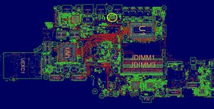

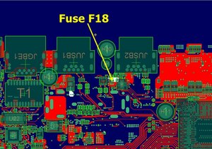

Gergely Hunyady we do need a better description from you about which port and what you have checked etc. I can really only find one fuse for the USB and it's located between the ports. Check it with a multimeter for continuity. Let us know what you find and more information is definitely needed.
This view is to make sure you can find the location a bit better.
