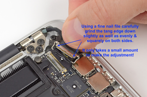

Now there is one alteration you will need to make with the displays LVDS cable as Apple switched vendors for the connector and cable. You'll need to carefully file the cable tang a bit so it fits. Here's what's needed
