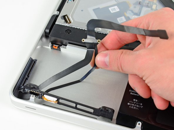

  11. MacBook Pro 15" Unibody Late 2011 Hard Drive/IR Sensor Cable Replacement: crwdns2935265:011crwdnd2935265:01crwdnd2935265:03crwdne2935265:0 MacBook Pro 15" Unibody Late 2011 Hard Drive/IR Sensor Cable Replacement: crwdns2935265:011crwdnd2935265:02crwdnd2935265:03crwdne2935265:0 MacBook Pro 15" Unibody Late 2011 Hard Drive/IR Sensor Cable Replacement: crwdns2935265:011crwdnd2935265:03crwdnd2935265:03crwdne2935265:0
    • Slide the hard drive and IR sensor bracket away from the edge of the upper case.
    • Carefully peel the hard drive and IR sensor cable from the upper case.
    • Lift the hard drive and IR sensor assembly out of the upper case.

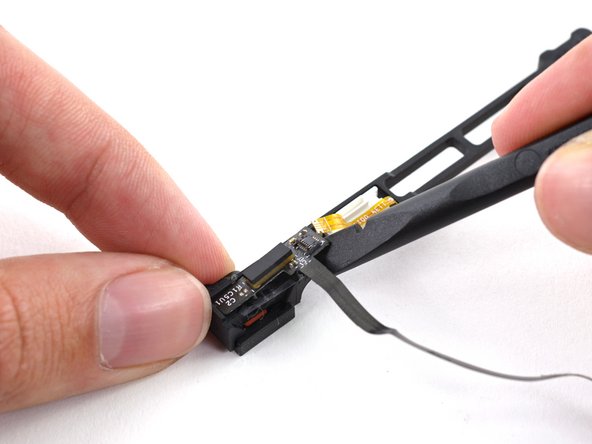

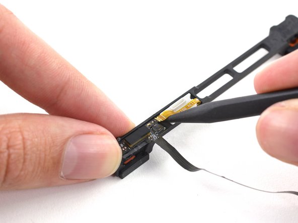

  12. MacBook Pro 15" Unibody Late 2011 Hard Drive/IR Sensor Cable Replacement: crwdns2935265:012crwdnd2935265:01crwdnd2935265:03crwdne2935265:0 MacBook Pro 15" Unibody Late 2011 Hard Drive/IR Sensor Cable Replacement: crwdns2935265:012crwdnd2935265:02crwdnd2935265:03crwdne2935265:0 MacBook Pro 15" Unibody Late 2011 Hard Drive/IR Sensor Cable Replacement: crwdns2935265:012crwdnd2935265:03crwdnd2935265:03crwdne2935265:0
    • Your replacement part may or may not come with the front (sensor) bracket. If it does not, you'll need to transfer it to your new cable.
    • Use the tip of a spudger to flip the ZIF connector on the hard drive cable.
    • Gently pull the sensor bracket cable out of the ZIF connector.
    • Use the flat end of a spudger to pry the hard drive cable up off the sensor bracket.
    • Remove the adhesive backing from your new hard drive cable, stick it onto the sensor bracket, and connect the sensor bracket cable.
