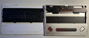

Like others here, my trackpad's battery swelled to the point of pushing open the backplate. I picked up the battery Patrik linked from AliExpress and performed the repair. The battery arrived in 25 days.
The backplate open:
A closeup of the two batteries for comparison:
I cleaned off the adhesive and installed the new battery. I clicked the backplate into place without adding more adhesive. The backplate stays in place on its own when sitting on a desk.
And, it connected without issue:
All features work.
