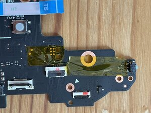

Where can I buy Left and right Daughter Board?
My Steam Deck fell down, from 80cm onto carpet but it was enough to destroy both R1 and L1 Shoulder Buttons. They snapped right from the daughter board, ripping the traces. No way to solder them back on.
Now I need a new left and right daughter Board but this part seems not to be sold as replacement. Since it was the first to break from a little drop, I imagine more people would need this soon.

if you are comfortable with a soldering iron i had the same issue and i used these buttons for a DS to fix. worked just fine. https://www.amazon.com/dp/B08GJLY5TR?psc...
He said that the pads have been ripped from the board. He'd have to rebuild the traces and somehow remake some mounting pads to do this and that's a lot to ask, even for someone experienced in smd rework.
ah didnt see that yep RMA good luck will probably take like a month. maybe find a part on ebay if you dont want to wait. for me the button just broke and the legs were still attached to the solder pad to just removed them and put a new button in place.
Do you need a soldering hot gun to remove the button? Possible to unsolder the existing button using soldering gun only?
Thanks in advance
The answer to this being posted is: "At this time, we are unable to offer these parts, as they both require software calibration (typically done at the factory) that is not available to end users at this time. We are working with Valve to offer these products as soon as we are able to, but we are unable to provide an ETA at this time."

Hi there! I accidentally dropped my Steam Deck on its side and the right shoulder button relay was shattered. My friend and I tried to solder on a new button using the suggested button, but there were a few complications with how that worked out... It worked momentarily, but I think the pressure I put on the button itself kept breaking the solder.
I eventually gave up and contacted their customer service, and got it fixed through United Radio. It took about 3 weeks, and $120 to get it fixed, which wasn't terrible if I'm being honest, but still. When I got the invoice back, they replaced both of my controller daughter boards, which leads me to believe that maybe the daughter boards have some kind of firmware on them that can lead to problems if not properly paired? It's unclear.
But this is the only way I could get this fixed. I wanted to let you folks know that at the moment, this is your best bet. Make sure to treat your electronics with respect. ><;;
In case anyone is reading this in 2024: https://repair.wiki/w/Steam_Deck_-_Repla...
I the pads under the switches are ripped out, you can run a wire to the testing point as explained in the guide.
Same thing happened to me with the left shoulder button. I managed to find the test pad on the other side of the board using the button test in the system settings. I kept shorting different testing pads until I found the one that triggered the L button.
Then I used some enamel wire to solder the middle pin of the button to the test pad. It has to be quite thin because the holder for the trigger screws on top.
The test pad will be different for every revision of the board. Mine is Revision G.
