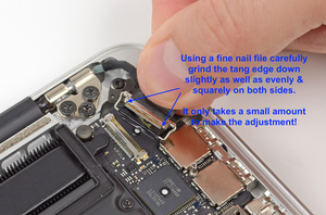

The only proviso is you need to make a slight modification of the LVDS cable. Nothing hard! Just use a nail file to file down the fiberglass tang. Here's the needed info:

Thanks it just came in the mail! Hopefully all goes smoothly...
Success! Wish I knew about this 3 years ago when it failed... I will look into a new battery. Thank you!
