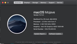

Hi,
My macbook pros battery just died (model number A1321 - 77,5 Wh), so i tried to search similar battery but most of them for this model is only 73Wh.
Finaly i found and bought a same/similar battery with 77,5 Wh, but i accidently missread the model number, its A1382.
Everything looks the same, except the connector, so basicly i cannot use it.
My question is: How can i change the connector itself. I simply cant find any good guide about the 8 cable lines, to check the differences between the 2 battery connection.

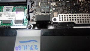

To make it more clear here is a picture of the 2 connectors:
Please kindly help me!
Thank you!

If you are insistent on doing this. I am counting 9 wires, not 8. The connector is a 9-pin type, 3 for ground, 3 for V+, SMC+ and SMC-, and one for system sense (center pin). The wires must be soldered together and the connections protected by heat shrink tubes. This will take away from their flexibility and may cause them not to sit correctly for the case to close properly. If you don't solder the wires and protect the connections with heat shrink tubes that may cause other problems.
The typical MBP battery connector pinout is:
1 +12V
2 +12V
3 +12V
4 SMBUS_SMC_BSA_SCL
5 SYS_DETECT_L
6 SMBUS_SMC_BSA_SDA
7 GND
8 GND
9 GND
Within reason I have given the information you requested. Batteries don't just die. Your battery is a little over a year old and should have plenty of life. It seems to me that this laptop may have other problems that cause you to believe your battery is dead. Did you confirm battery health with Coconut Battery or iStat? Has this laptop experienced liquid damage? Please tell us more about why you believe the battery is dead.

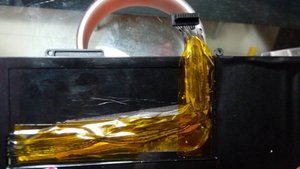

Well i bought this mac with an already dead battery (battery health is between 10-25% must be somekind of battery defect - tried all kind of fixes..) - call it 1st battery.
So i bought a replacement via ebay (the same good connector but only 73 Wh) Please note that the replacement battery was already used and battery health was 70-74%. - call it 2nd battery
The Mac works well, this battery is sable. But i planned to buy a full original one. (A1382 with lately realized with different connector - call it 3rd battery) Since im kinda tired to search again and spend again a bunch of money for an another battery i would like to remove the connector from the "1rst battery" and put it on the 3rd.

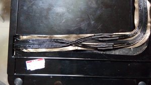

The wires must be soldered together and the connections protected by heat shrink tubes. - Im planning to do this, but first i wanna know the connector pinout differencies to avoid any damage on my Macbook.
Thank you for your kind help!
ABCellars, thanx alot! This worked for me. Changed the wires - all is fine!
I had the same/similar problem. My battery "got pregnant" and was pushing out to the touchpad. So I decided to replace it. Unfortunately I bough battery for newer version of MacBook Pro (15"). I was too lazy to return it and order new one, so I searched for another solution. I came across this thread where pinouts were written. After small research (or I should rather call it experimenting) I found a solution :-)
The above answer where you cut the fatter connector to fit is wrong. If you would look closely you will see that the + and - pins are reversed between these two connectors. On each connector there is a mark for + and -. So cutting it down wont help.
If you have both batteries, you need to disassemble them and exchange connectors between them. The control pins are on both connectors same. So while one connector has pins in this order

Be aware! Without proper tools (like soldering iron, etc) and at least some technical skills you wont get too far.
I exchanged connectors today. Battery got detected and has no problems with charging it. In case of any complications, I will write here again for more information :-) Good luck everyone!

Just swapped the connector from an A1321 battery onto a new A1382 using this pinout. Made sure to check with a multimetre first just in case. I stripped the leftmost and rightmost wires on each battery and tested both on DC voltage mode to make sure I had the order right. The connectors are in two different orientations so I can imagine it would be quite easy to put the new one on in the wrong direction if you're not paying attention.

Far more simple:
Open the connectors and reorder the pins.
No cutting into the battery, no soldering.

No it's very simple. I popped it open with a small knife.
How do I change it?
1=7
2=8
3=9
or
3=7
2=8
1=9
Without any research or a second thought, I did 1/7 2/8 3/9. I would imagine either way should suffice, but don't quote me on that.
i just did the same , and it works , no soldering, no tape , justo re order de pins

I modified battery A1321 to A1382 model and used on MacBook Pro mid 2012
It work for ME..:-)

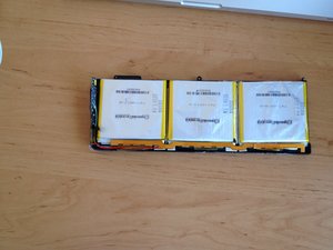

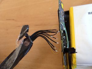

Its pretty simple. You need to open the shelf of a battery. You can do it only with some strong screwdriver and lot of force. You will need to destroy the package. Be sure to destroy the softer side of a package. That one on which the cable is sticked in. After you will finish you will end up with something like this (cable is already removed):
Then you use the soldering iron to remove the cable. You may want to use desoldering suction pump to clean the contacts. Otherwise it will start overheating very fast. It will also leave you with clean holes, so putting there exchanged cable will be much easier.
As you can see on a photo, the three control cables are marked. One has a grey strip on it, one has black strip on it and third one is clean. So be sure not to mix these three cables.
Be aware, if this will destroy your mac, I'm not the one responsible for it :-D Maybe even mine will burn up one day :-D But so far still no issues with my battery. Lucky me :-)

So basically what I'm asking since you ripped both batteries apart can you show a picture of the 2 pcb's inside the batteries showing that the + and gnd lines are indeed switched.
This allows future hackers including myself to just resolder the connector without ripping apart the new battery. And I will post pictures on how to do this by just resoldering 9 wires instead of mangling 2 battery cases... Also as a benefit the newer A1382 can be gotten with a higher 77+ amp rating vs the original which would give extra battery life (more than the original hooray!).

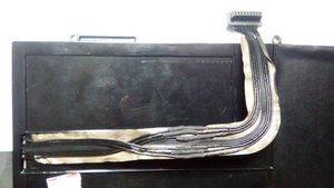

My Macbook Pro had the A1321 battery and I acquired the A1382 battery by mistake. I noticed the connector was different (and also wondered if the firmware could be different). First I have tried to cut and join/solder the nine wires exactly in the same order, just to find it does not work (battery is not detected).
Then, I have found jozefvaclavik’s post saying the pins were also reordered in the new model. I have cut them again and rejoined/soldered in the new order. Works like a charm and I’m sending this message from a happy Mac Book Pro.
All I have done was to invert wires 1, 2, 3 with 7, 8, 9 (leaving 4, 5, 6 as they were before).
If you are doing this, do it one cable at a time (your battery probably came charged, and if you touch the wires you will get a short circuit) and put a some insulating tape around each cable. I have used tiny pieces of insulating tape, carefully covering the joined wires, because I wanted to ensure I would still be able to fit the battery back in the same location.
Took me more time than expected, but I’m happy that I do not need to throw this one away and buy another one.
