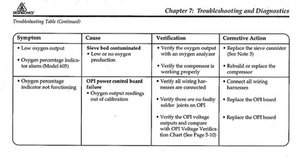

My millennium m10 oxygen concentrator low oxygen light shows.... Then after about 2minutes, the service required alarm sounds continously..... What should I do???
Alfred Ohanyere there could be lots of reasons for it and without the proper tool like an oxygen analyzer you may be looking for getting somebody with those tools to help you. For now I sugest that you checkThe service manuals on here Respironics Millennium 10 and read through those. Could be as easy as replacing the sieve canister.
need to take it to a service shop, or verify that the flowmeter is open if it is closed would sound alarm.
