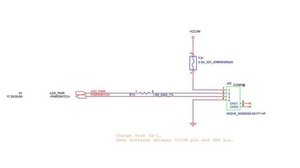

I'm now wondering if you have a faulty power on button.
IF the motherboard is model number NM-B481 REV: 1.0 (printed on motherboard) then here's an image of the lid switch connection.
Use an Ohmmeter to check that when pressed there is an earth on pin 3 and that it is not there when the button is not pressed i.e. sticking contacts perhaps. Disconnect the battery when trying this
If it is OK then here's a link to the schematics that may help. Again this is only applicable if the motherboard's model number is the same as for your motherboard. If not what is the model number of your motherboard?

Hi there, thanks again for you answer! Regarding the power button, I am wondering, because when I press the button, the laptop tries to boot (fans start spinning and stop immediately again) and the light of the power button, the esc key etc, turn on. Wouldn’t that indicate that the button is working?
Also, it might be important to mention that so far, when I tried often enough pressing the button, eventually the laptop turns on and works flawlessly for days/weeks. However, yesterday evening It was turned on but the battery went empty. Since then, although charged again, it does not boot any more. No matter how often I hit the power button, the lights go on and off, etc.
I wonder, if there is anything else I could do as if the motherboard would be broken, it shouldn’t run at all any more, should it?
