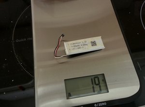

Info about battery can be found here.
https://www.reddit.com/r/ValveIndex/comm...
PL802056V 3.8V (model number)
1100mah 4.18Wh (specs)
+18100604-1 (this looks to be battery serial number, as I found 2 different ones)
More details in my own disassembly:
10.78x56.86x21.47 in paper fold with rubber pad and expanded chamber and control board (finished battery).
50.59x19.24x9.62 just the normal dimensions without control board and expanded gas chamber (just the cell without wires/board).
Model number under paper is the same: PL802056V 3.8V 1100mAh 4.18Wh
Serial number is different from the paper wrap: 19072902-1
The image of the guide containing the information:
Not sure if that helps but usually the model of the battery shows the dimensions, so 802056 would be 8mm x 20mm x 56mm. It would be great if someone confirms the dimensions. Also, LP could be for lithium polymer.
Two notes from the guide:
  • the og battery is 3.8v nominal and the controllers charge it to over 4.3v, if you use the controllers to charge an external cell do not use a regular 3.7/4.2v one or it will explode.
  • The white wire from the original battery seems to be for a thermistor as it measures ~10kOhms to ground
With all these information I still can't found a replacement battery to buy :-/
https://www.reddit.com/r/ValveIndex/comm... I disassembled a controller just yesterday.
10x20x51 is just the battery module without control board
