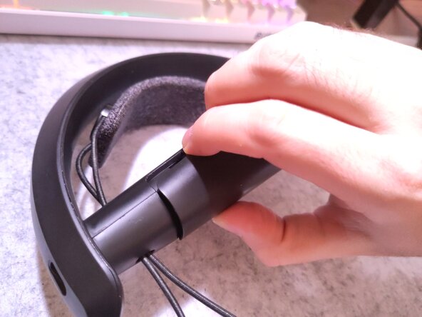

This guide will demonstrate one way to disassemble enough of a Valve Index controller to reach its defective battery and replace it with the closest known replacement battery.
This is a tricky part to get into, despite the small number of screws and reliance on clips. There are several ribbon cables in the way of the battery, as well as sharp corners around the housing, and the adhesive can make the removal a slow and dangerous process.
There's no way to fully disassemble the Index controller without prying off the cement holding the outer ring to the bottom of the main handle.
Take caution to not rip the cables or puncture the battery.

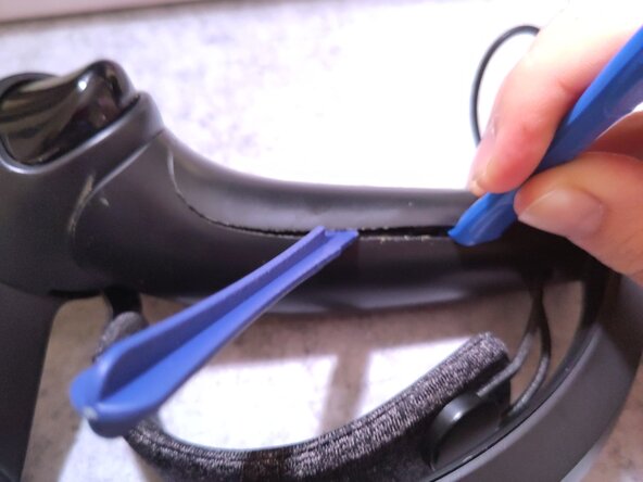

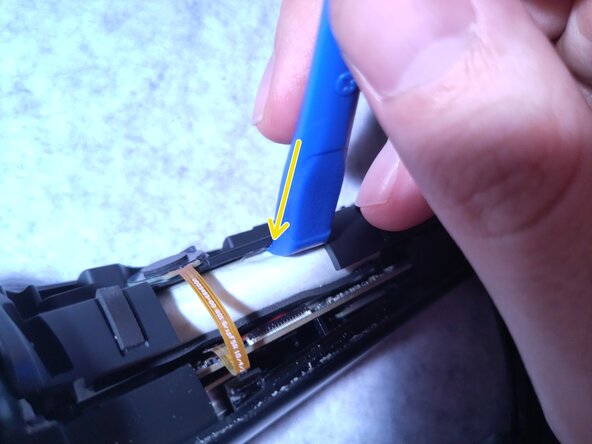

    1. Valve Index Controller Right Index Controller Battery Replacement, Open controller grip: crwdns2935265:01crwdnd2935265:01crwdnd2935265:03crwdne2935265:0 Valve Index Controller Right Index Controller Battery Replacement, Open controller grip: crwdns2935265:01crwdnd2935265:02crwdnd2935265:03crwdne2935265:0 Valve Index Controller Right Index Controller Battery Replacement, Open controller grip: crwdns2935265:01crwdnd2935265:03crwdnd2935265:03crwdne2935265:0
      • Use either a guitar pick or thin sheet of metal, pry open the grip sensing panel.
      • There are five plastic clips around and under the grip sensor. Use the tool to pry up around the sensor to lift it out of the handle.
      • Tuck in starting closer to the top of the controller, and apply force to lift the panel away. Move further around the sensor, using a second tool if needed to keep the grip sensor off of the handle.
      • With gentle force, the propped grip can be removed from the main handle.
      • Be careful when removing! There is a ribbon cable underneath the panel, tucked between the circuit board and outer housing, and attached to the circuit board buried inside. Make sure the cable doesn't detach.

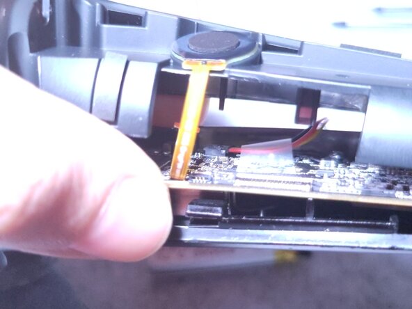

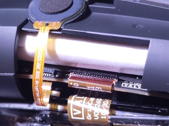

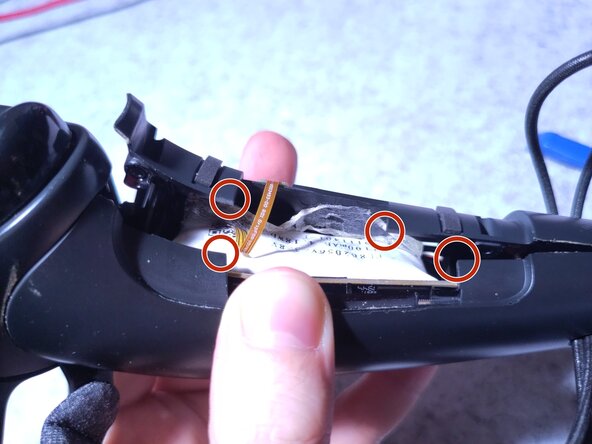

    2. Valve Index Controller Right Index Controller Battery Replacement, Detach ribbon cables: crwdns2935265:02crwdnd2935265:01crwdnd2935265:03crwdne2935265:0 Valve Index Controller Right Index Controller Battery Replacement, Detach ribbon cables: crwdns2935265:02crwdnd2935265:02crwdnd2935265:03crwdne2935265:0 Valve Index Controller Right Index Controller Battery Replacement, Detach ribbon cables: crwdns2935265:02crwdnd2935265:03crwdnd2935265:03crwdne2935265:0
      • There are two ribbon cables in the way of the battery that must be removed.
      • Each ribbon cable is fragile, and pinching either one incorrectly can rip it, causing grip functions to not work anymore.
      • The smaller ribbon cable is wrapped around the top of the battery and inserted into the circuit board. Use tweezers to free the cable and detach it from the board.
      • The larger ribbon cable is attached from the back of the grip panel to a wider connector on the circuit board, held down by a black connector lid.
      • Use a thin, flat spudger to lift the connector lid, then pull it out from the circuit board to disconnect the grip panel from the conntroller.
      • Do NOT use a sharp metal tool to lift the connector. Doing so can risk puncturing the battery, causing a fire!

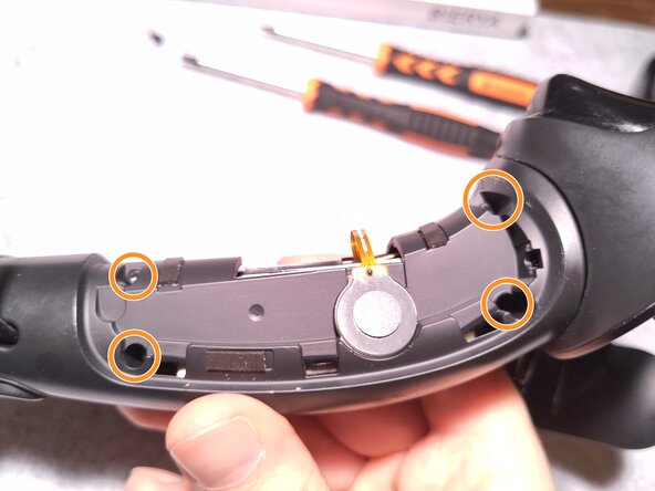

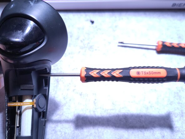

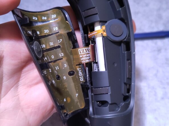

    3. Valve Index Controller Right Index Controller Battery Replacement, Unscrew the housing: crwdns2935265:03crwdnd2935265:01crwdnd2935265:03crwdne2935265:0 Valve Index Controller Right Index Controller Battery Replacement, Unscrew the housing: crwdns2935265:03crwdnd2935265:02crwdnd2935265:03crwdne2935265:0 Valve Index Controller Right Index Controller Battery Replacement, Unscrew the housing: crwdns2935265:03crwdnd2935265:03crwdnd2935265:03crwdne2935265:0
      • Unscrew one (1) Torx T9 screw on the side top.
      • Unscrew four (4) Torx T5 screws around the side of the housing.
      • The Torx screwdriver needs a long, narrow extension; the screws are in deep inserts.
      • After all five (5) screws are removed, use a rigid spudger to pry open the battery housing from the controller handle.
      • The controller cannot be fully disassembled; there is significant cement-like adhesive on the bottom and around the knuckle ring of the controller. There's no known way to open the controller further without destroying it. Only pry it open far enough to expose and extract the battery.
    4. Valve Index Controller Right Index Controller Battery Replacement, Remove the adhesive, then the battery: crwdns2935265:04crwdnd2935265:01crwdnd2935265:03crwdne2935265:0 Valve Index Controller Right Index Controller Battery Replacement, Remove the adhesive, then the battery: crwdns2935265:04crwdnd2935265:02crwdnd2935265:03crwdne2935265:0 Valve Index Controller Right Index Controller Battery Replacement, Remove the adhesive, then the battery: crwdns2935265:04crwdnd2935265:03crwdnd2935265:03crwdne2935265:0
      • The battery is securely adhesed to the housing; use a hairdryer or hot air gun at moderate heat for 10 seconds to loosen the adhesive.
      • Use a plastic guitar pick or spudger to separate the adhesive from the plastic housing. There should be less resistance; if it's still not budging, re-warm the area and try again.
      • Do NOT use a sharp, metal object; this will risk puncturing the battery and causing a fire!
      • This adhesive is very tough, lasting several years. Be patient cutting through.
      • Once the adhesive is freed, separate the controller apart more to handle the battery, and remove it from the main handle.
      • The battery is plugged into the printed circuit board via an MX2 connector.
      • Be careful when removing! The inside chamber holding the battery has several sharp corners that could puncture the battery, and cause a fire!

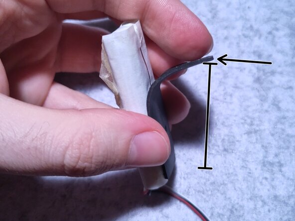

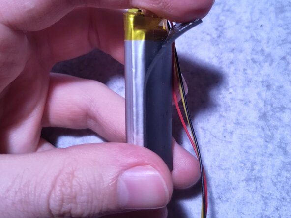

    5. Valve Index Controller Right Index Controller Battery Replacement, Transfer the rubberized part.: crwdns2935265:05crwdnd2935265:01crwdnd2935265:03crwdne2935265:0 Valve Index Controller Right Index Controller Battery Replacement, Transfer the rubberized part.: crwdns2935265:05crwdnd2935265:02crwdnd2935265:03crwdne2935265:0 Valve Index Controller Right Index Controller Battery Replacement, Transfer the rubberized part.: crwdns2935265:05crwdnd2935265:03crwdnd2935265:03crwdne2935265:0
      • There is a rubber strip stuck on one side of the OEM battery, protecting the printed circuit board from the battery,.
      • SAVE THIS PIECE. It is a crucial component to prevent battery damage.
      • Separate it from the white housing, and replace it onto the replacement battery.
      • Install the new battery, rubberized side facing the printed circuit board, and apply a replacement adhesive strip on the other side of the battery to keep it stuck on the outer frame.
      • When ready, unplug the old battery from the circuit board, and install the new battery's cable.
