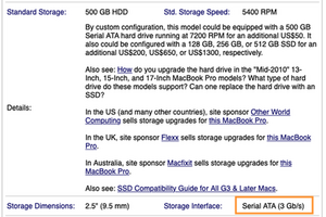

Sadly you likely did your self in here with the SSD as your boot drive!

Update (03/23/2022)
Here’s a image of the SATA I/O speed

@scottbernardis - You'll need to take out your Crucial MX 500 SSD as its too fast for your systems SATA II I/O which in turn causes the system to over heat!
You'll need to get either a fixed speed SATA II drive (3.0 Gb/s) or go with an auto sense drive like the Samsung drives even the newest 2.5" drives are still auto sense.
To know if the drive will work the spec sheet MUST clearly state either 3.0Gb/s or SATA II. That will fix your problem!
Reference: 17" MacBook Pro Mid-2010 I've also posted a snapshot of the SATA I/O section in my answer.

Back to my system, so to confirm, both my primary and optical i/o are sata ii? And same question, any benefit to switching drive locations until I get new drives? Switch MX 300 back to primary, and make it boot, and move MX 500 to optical as data only?

Correct! Your system is strictly 3.0 Gb/s (SATA II) Moving the drives around won't really change things as the blessed drive (booting drive) is the key If the MX 300 has the OS still installed all you need to do is go into Startup Disk preference setting. Making sure th MX 300 is the boot up drive.
