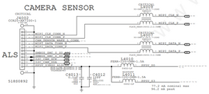

I've recently figured out that for some reason my facetime camera is not working even after SMC or PRAM reset procedures.
I was able to locate the problem and it was an L4010 chip near the backlight connector of the keyboard.
Due to my mistake, while I was working on the keyboard, I've accidentally connected the facetime camera connector while the battery is connected. I think this caused the problem.
To fix the issue, I was able to order the chip for L4010 which is FERR-120-ohm-1.5A from Digikey.

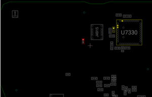

The problem is that due to the burnt L4010 chip, the PCB pad is missing, and need to find another place to solder the chip by jumping wire.
Is there any good place to put jumper wire for the chip?
I've included some ref photos for the boards.
@martini964 here you go. Contact 1 from L4010 to C7330 contact 1 for PP5V_S0 and L4010 pin 2 to pin 12 of J4002.

No, it will not cause you any grief down the road. Use some thin insulated strand of wire. I use wires from an old LVDS ribbon cable but ultimately any thin copper wire will work. Just make sure you use some insulating paint on that wire/solder points after you soldered everything in places.
@martini964 - I would use a small patching PCB board to mount the SMD device and mount it near where the part was then feed the wires to it PCB test board Cutting off a section of the board to the size you need.
What you don't want is the have any shorts to the ground plane that is surrounding the SMD's originals location.

The inductor pads are located in the middle of the ground plane which is that large copper surface that surrounds it. At this point you’ll need to locate a point where you can solder patch wires. Using the boardview locate PPv5V_S3RSO_ALSCAM_F line (ALS contact #12) as well as PP5V_SO. Now solder the SMD onto the wire make sure the lines are as short as you can ands insulate them.

The size of the exposed via line passing through the layers is not large enough to solder onto and physically connecting to the sub millimeter exposed point won't be strong enough.
Sorry, the limits here are physical you need to find another location to tie into.
Sounds like you've hit your tools and skills limit, see if you can find someone with the needed tools and skills to help you otherwise its time for a new logic board. Sorry ;-{
