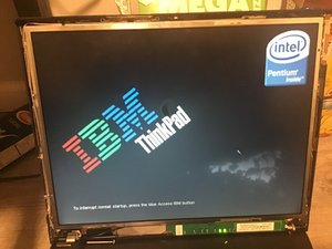

(tries to look up datasheet) Oh, and you thought NOW it’s a perfect time to turn yourself on?! Battery, too.
(hurriedly put it somewhere secure and plug it in and take picture of splash screen)
(presses power button) uh … can you do something? I pressed “access ibm”, but … hm. it appears to be frozen. hello? (press and hold power switch before pressing to turn it back on) Ok. now it will start, but the screen is black. At least we have a picture of the splash before .. well, since now it’s half-dead again why dont we look into the chips?

The whole point of this is because the first time the screen turned on (before I started to short things together) it post, and it displayed two error codes, and I went into BIOS Setup. And more annoying is because I didnt take a picture of that error code screen. However as I described, immediately powering it down (and powering back up) and I am greeted with a black screen instead. I understand there must be patience but … I don’t think this is about being patient. there is definitely something wrong with it.
