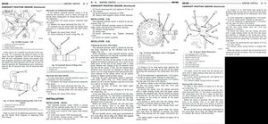

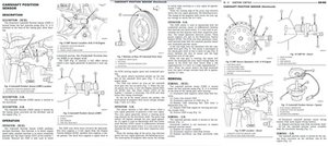

My 02 ram 1500 5.9l gas died as i was driving yesterday . I have fuel pressure and the coil has spark going to distributor. It turns over and sounds normal cranking but wont start. Recently ive replaced the fuel pump and coil along with distributor wires and rotor all have under 600. Any suggestions ?
Hi @dirtyboot,
Check the OBDII codes. There may be a problem with the camshaft position sensor (P0340 code) or the crankshaft position sensor (P0335 code)
If it is the camshaft sensor, here’s information from the service manual that may help.
(click on images to enlarge)
