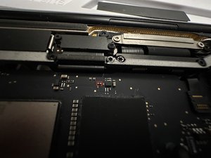

Yesterday I replaced the keyboard and its backlight on my M1 MBP, rivets and everything. No, it wasn’t because of any water damage.
It went well, except for the fact that True Tone is gone and my MacBook thinks it doesn’t have a camera. For context, here are the final steps I took in the reassembly:
  • With everything but the screen installed, I plugged the MacBook into my external monitor and turned it on to test it.
  • It worked, so I unplugged it but neglected to turn off the machine (rookie mistake)
  • After installing the screen and closing it up, it was initially blank even though I knew the machine was on. The display worked after a forced restart.
Here’s what I’m dealing with:
True Tone is gone from the Control Center and Displays Preferences
The system doesn’t detect an internal camera
There is now a second ‘Color LCD’ ColorSync profile
Oh, and here’s a screenshot from Sensei, which shows some info about the connected display.
I know that the M1 has the capability to lock certain features if it detects a third-party component (WHY?), but I used the original screen from the laptop.
Any ideas?

I finally fixed my laptop. Here's what was wrong, and I have some extra things to look out for if you're having the same problem.
Solution
I had to replace my display cable.
The display cable takes care of the display, as well as the camera and sensor array. Here's a photo of my broken cable (left), and the replacement cable (right):
See the vertical line that runs by the number 8 on the left cable? That's not on the replacement cable.
Perhaps my display cable was always defective, and fondling with it caused a connection to break.
"That didn't fix it!"
Look closely on the logic board, and try to locate this (very small!) component:
If it's visibly blown, then this is likely your problem. If you don't have access to precise board-level repair tools, you're SOL unless you can get a repair shop to fix this for you.
This section "Camera not detected after history of liquid damage" on Repair Wiki describes the process to getting this component replaced. Good luck!

@jackhinkle - So why did you go through this exercise? Clearly something must have been damaged here, maybe the root issue is the original damage just effecting the display. Did you drop the system or have something sit on it?
@danj Alright, quick pause.
In my question, I mentioned that I broke the #1 rule of repairing electronics and reinstalled the display with the battery connected. (Ouch)
I found an answer on a question with a very similar issue:
Why has True Tone disappeared after screen replacement?
They mentioned something which is quite concerning:
"...or that your battery screw was not removed well before the lcd is replaced can short out the camera or True Tone component circuit on the Logicboard."
Once I get home, I'll disconnect the battery and reseat the display connector. I'll close this thread with an answer once I'm done.
