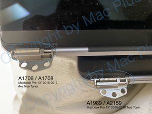

Why has True Tone disappeared after screen replacement?
Replaced LCD assembly (with correct 2018 screen) on MacBook Pro Touch Bar 2018. I noticed after reassembly that the Touch Bar is constantly on full brightness, and the keyboard backlight is always off.
While trying to troubleshoot the ambient light sensor, I went to check if True Tone was enabled or disabled, and noticed the “Automatically Adjust Brightness” and “True Tone” options have vanished entirely from Display Preferences.
What’s happened?

What I can tell you is the 18/19 use a very different display than the older models. What happens is people use the older one 16/17 which is cheaper and if it came from a parts system will have the shorter backlight cable.
Here’s the correct display assembly:
This is what you likely got even though the P/N you gave me is the 18/19 Space Grey display assembly. The only other possibility the part was either mis-binned or the part was mis-marked.
It's possible. The part was comprehensively labelled as an A1989 (rather than A1706) replacement, and looked in every way similar to the one I removed.
Is there any way visually or through the OS to identify which of these two the screen actually is?
Sorry I don't of any way physically as the display assembly looks the same.
I don't have a system presently so I can't tell you if this works but you could look at the displays config info in System Report under About This Mac and then going to Graphics/Displays see what it tells you.
No. The A1706/A1708 and A1989 original LCD Assemblies are not identical. It is super easy to tell them apart.
Just look at the hinge. The A1706/A1708 hinges do not have rings, while the A1989 and above have sort of lines and rings on them. True Tone, Ambient light sensors will all work if you use the original LCDs. They don’t need to be paired or calibrated by an AASP. Not sure about the M1 models yet. Even the ifixit publishers sometimes get their info wrongly.

The hinges for the Macbook Pro 13” 2016-2017 (A1708/A1706) are physically different from 2018-2019 (A1989/A2159). This only applies to original Apple parts though.
Aftermarket third party OEM LCD assemblies may reuse the same shell but put in a different LCD inside.
In any case, if you use a 2016-2017 on a 2018-2019 Macbook Pro, not only will True Tone not work, the entire LCD will be extremely dim after it logins to the desktop to the point it is nearly not visible.
So if the display works, but there’s no True Tone, it means your OEM or Third Party part or the original part has a failed True Tone camera. It is rare, but possible for original parts not to have Facetime camera or the True Tone sensor working.
