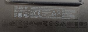

@jayeff Yeah best to double check but it's probably 19.5V like a lot of non USB-C Dells. It usually says on the bottom what the voltage is like 19.5V on the 7440. I'll check my 7490 later but I think it's on the label as well.
@jayeff I posted a photo of the label that tells you.
The issue on some especially with a bottom replacement (though this happens more with "full fat processor" Dells, not ULV in most cases) is the amps don't always match, but if you want to check the tip voltage it's not an issue. If you put an i7 bottom on a i5 6440, then it will have the sticker for the i7 which points to 90W if you do VxA=W, when those need the 65 but benefit from the extra headroom.
That laptop uses a 19.5V wide barrel tip, which is extremely easy to find and can be purchased at any store where laptops are sold, especially stores that sell Dell laptops. The thin one can be a challenge, but not the wide tip, because of how many laptops use it. Your Chromebook uses the same tip as my Lat 7490.
As long as it meets or exceeds the factory wattage on the back of the Chromebook (Likely 45W or 65W) the adapter will work. It matters so little that I could let you use my 130W adapter as long as our tip voltages are the same (19.5V), despite the fact that it’s a total waste for a Chromebook. The adapter only draws what it needs, so if you only need a maximum of 65W on a 130W adapter, you’re leaving 65W of maximum capacity on the table. Yes, sometimes mine is a waste too (like on mid-spec 7490s with the i5, which can run comfortably with the 90W adapter), but on the other hand, if I power an i7-8650U 7490, that headroom is potentially useful. Even the 8th gen or newer 4C/4T or 4C/8T U series CPUs are not power sippers once you step into the world of i7, but aren’t power hogs like the old 47W MQ Haswells - they never made it into the E6440 for a reason.
Check this label on the back of the Chromebook to be sure:
