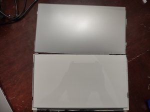

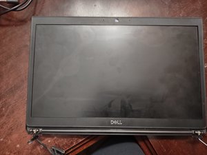

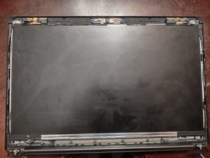

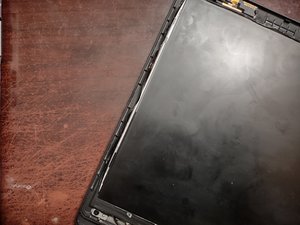

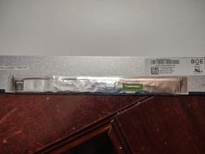

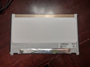

@oldturkey03 Here’s the promised destructive teardown (erm… reference) photos.
READ: This display was cracked, and I swapped it with a secondhand IPS FHD assembly from a liquid damaged laptop that was intact. Nothing was wasted, as I keep it for a spare magnesium lid with bezel for a non-IR 7490.
Within the assembly/removed from assembly. Notice the fact the seal is “one way” and cannot be reversed:

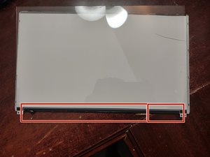

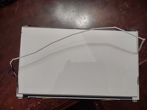

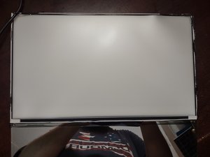

Tearing the panel down to show how the backlight is integrated:
Within the area marked in red is where the strip is. There is no way to get this out without destroying the LCD :-(:
@ping98 that looks like your screen is having problems with the backlight LED’s. We would need to know the exact number from the label of the screen to see if the backlights are integrated. In that case you would need a new screen in order to fix this.

@oldturkey03 I'm familiar with them. You can't - they're secured with tape to a plastic frame backing it. Unless you can redo the tape, the "thin" panels in modern laptops are non-serviceable. The SLP panels are no better - they may be worse.
I have a cracked 7490 "SLP" panel from an assembly (I'd need to disassemble it but as it's cracked IDGAF about preserving the seal) to show you what I mean, if you'd like. I'm willing to open the cracked SureView panel in the assembly so you can see, but that's only being taken apart 50% so if I get a deal on a SV touch panel, I have a good shell. I have these because what often happens with bad screens is I can usually negotiate an assembly for a few bucks more then the price of the raw panel, so I swap it as a unit. I keep the shell with bad LCD for parts like bezels.
@nick if you have an old panel, lets take a look at it. I know that some are referred to as integrated backlight LED‘s (most of them now to make them even thinner)
