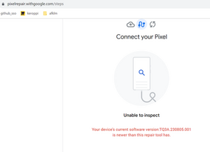

I have similar issues with calibrating my pixel 6 and new screen/fingerprint reader. In rescue mode (not fastboot) the phone is recognized / selectable from the pop up. After that it will communicate with the phone and complains about software incompatibility.
I spend a 45 min chatting to a Google service employee but after countless unnecessary question the only answer was: "You could bring it to a pixel 6 service point near you". Right... living in Amsterdam that is Koln - Germany. I've been there already the first time my screen broke. That's an 7hr roundtrip.
So screen works fine, recognized the phone but somehow the software of the webapp https://pixelrepair.withgoogle.com/udfps and my phone play update July 1 of 2023 and security update from 5th of August 2023 aren't compatible.

VERY IMPORTANT NOTE: I had the same issue where it was not recognizing my device in fast boot mode. The mistake I made was I was trying to update the usb driver when the phone was on. Then, I tried updating/downloading the driver when the device was in fast boot mode. This ended up working and it was able to recognize my device, update the software, and calibrate/fix my fingerprint reader. Hopefully this helps!!

Hi, there may be an update between Android and Windows merge for software compatibility. Varying on OS and software's version, USB debugging might be an issue for web calibration. Try to attempt to use the web calibration in desktop mode. Sorry for the late reply.
Here are the steps,
  1. Download the Google USB Driver.
  2. Following the fingerprint sensor calibration steps in the link below.
    1. https://pixelrepair.withgoogle.com/udfps
  3. After connecting your phone to the USB cable, install the Google USB driver by following the step in the link below.
    1. https://developer.android.com/studio/run...
  4. Then click on "Connect Phone" and follow the steps to complete the calibration.
