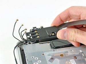

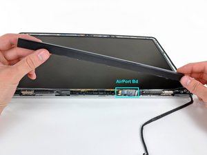

The 2009 15” MacBook Pro AirPort board, Apple P/N 661-4766 sits within the Clutch cover with the antennas. It only offers WiFi as there is a second board for Bluetooth.
The 2011 15” MacBook Pro uses a combo board which is also larger AirPort, Apple P/N 661-5867 and sits within the main case
You need to use the correct part for your system.

@chjowh - The link works, iFixit is just out of stock. I posted both so you could see the images of the two parts.
Here's another source 2009 802.11n Wireless Card, Apple P/N 661-4766
